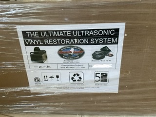

« Reply #14 on: 23 Feb 2022, 11:36 pm »
https://www.audiocircle.com/index.php?topic=180565.0
I still have to unpack my Kirmuss Upscale Audio cleaner and start using it.  I’ll also use my VPI 16.5 “glorified” vacuum to dry.
