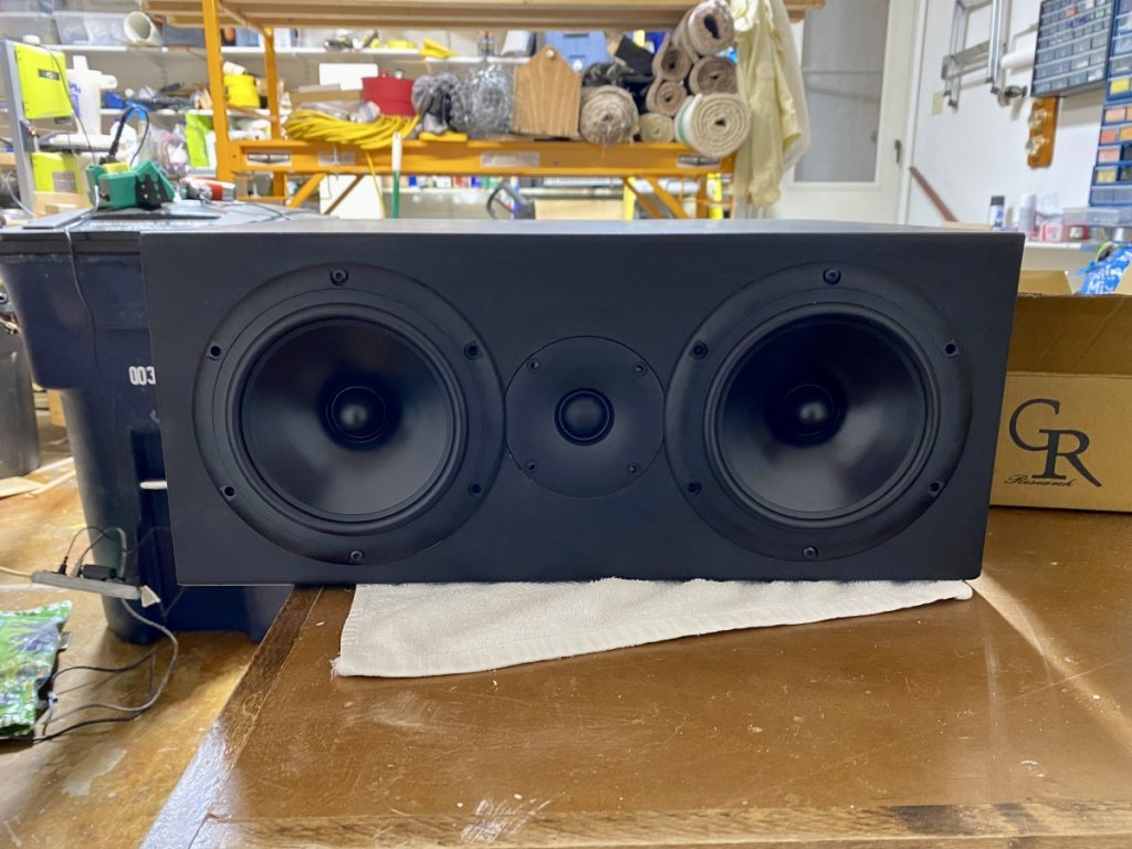

Have you designed speakers and crossovers?
The speaker you describe matches the GR Research X-CS Center Speaker. Danny at GR Research has been designing speakers for a long time. He would answer any questions about frequency cancellation or other stuff mentioned in the video as regards to the X-CS. That would be my starting point for a DIY speaker.
https://gr-research.com/product/x-cs-encore/
Plenty of info in the GR Research Circle - ask questions here
https://www.audiocircle.com/index.php?board=16
X-CS Encore - Sensitivity is 90db, sealed box

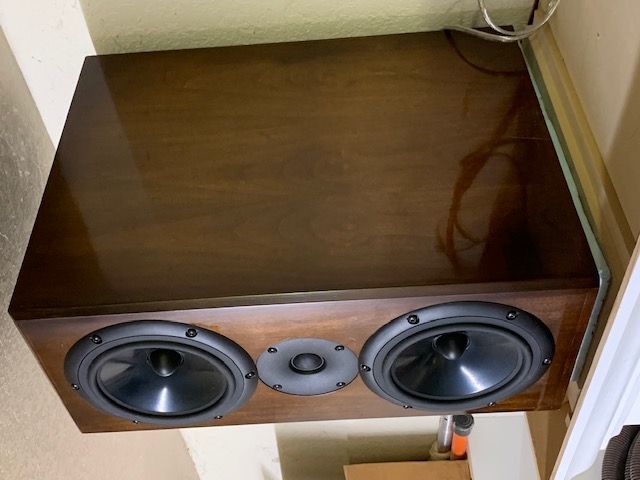

If doing a 2 way, this a driver layout like this would be best:

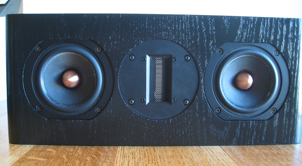

I'm on my third center channel speaker.
The first was a JBL 2500, I found a pair at a yard sale super cheap. The experiment was educational and didn't sound that good.
The second was RAW HT2C with the excellent Aurum Cantus ribbon tweeter. The specs looked fantastic:
- 2 x CSS WR125ST 4.5" matched woofers with cast aluminum frames, copper phase plugs and XBL² motors
- 1 x Aurum Cantus G2si ribbon tweeter
- High quality parallel crossover network
- Solen air core inductors
- Solen polypropylene capacitors
- Silver wiring
- Well constructed enclosure lined with 1" Ice Absorption sound damping material
In reality the speaker wasn't that clear and dialog was still hard to understand plus the rear ports gave an unnatural resonance to male voices.
The third is a Salk HT2C center channel and it is perfect. The speaker is a sealed design and the drivers are the same as in my L & R speakers. The Seas W18 and RAAL tweeter are fast and clear so the center channel intelligibility is extremely high, my guests and l have no problem understanding dialogue.
The sound in my home theater only became seamless when all three speakers, L, C, & R, were the same. When the soundtrack and dialog can move between speakers without a change in timbre it results in a more immersive viewing experience. The center channel is the most important speaker and should be equal to if not better than your L & R speakers.
What are your L & R speakers? Can you use the same drivers for the center channel speaker? It is important to keep the voicing the same to end up with a successful build.
This does deal with the problem of cancellation, as long as the crossover point is below the wavelength distance between the center of the two woofers (which it probably is).
This assumes I know what I am talking about which is what I am hoping to get confirmation of.
  • Posts: 11595
Re: Center Channel design question(s).
« Reply #11 on: 10 Feb 2022, 06:56 pm »
Correct.
