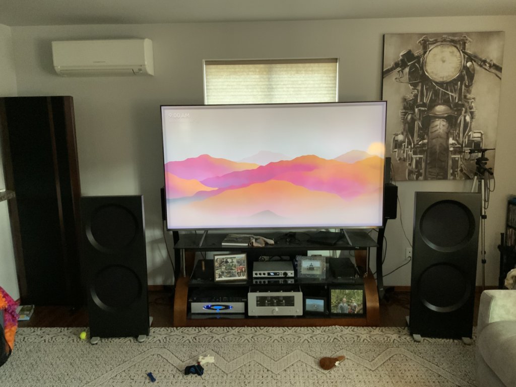

Audirvana to microrendu to Exogal Comet to LTA z10i.
The Comet is a terrific dac with no rep of being bright. Don’t tell me I need a Lampi or Denifrips or Border Patrol to fix it.
Let me be clear.  On great recordings it’s bliss.

Dirac Live comes to mind, that is what I have ended up using until I can get my room fully treated. Night and day difference. Not for everyone I realize, but after endless hours with and without, I'm a believer !! 2db shelf from 3k-5k in my room anyway. As we all know, room conditions can trash a speakers perceived tonal balance that is otherwise spot on.

Had some friends over yesterday but didn't listen to any of the "problem" records - which again are 10 or less percent of my collection and what I listen to - probably <2% or less now that I think about it. Please note that on all of these "problem" records, they are still in my top recordings section of my collection. Reason being in the "cleaner" parts of the record, meaning w/o screaming guitars, they sound REALLY GOOD - it is only screaming guitars that is an issue. They are also very highly rated on discogs although I realize those are heavily system and ear dependent.  :D
That said, Tool - Undertow (promo) and RATM (1st album) sounds almost unbelievably good and both are fantastic recordings and although they do have heavier electric guitar they are still a "cleaner sound" than (most of) Siamese Dream.
Once my room treatment stuff arrives I'll listen to my "problem" recordings and report back.
Brother's amp is here but haven't tried it yet. Same goes for the new preamp tubes.
Most of my listening is to "regular" rock and electronic music like Thievery Corp and K&D along w/ some jazz and jazz funk (Maceo Parker) - but most is "regular" rock like PFloyd, F Mac, Beatles, Dire Straits, Santana, etc.
I even told my buddies this system isn't built for hard rock and if I have to skip listening to some albums or listen to at a lower volume (which I usually have to anyway), I'll live.  :green: but will keep working at this.

I hit on this on my long post above but I really don't think it is the recordings or the tubes or even the amp itself because:
1.for the records: these records sound great (!!!) below 83 db
2. for the amp/tubes: my other records sound great (!!!) up to 95-ish db which is usually as high as my peaks go when the wife has left the building. :)
I sense that for these recordings - mostly heavy electric guitar, but that isn't the case with Pearl, that when the sound gets "busy" that these certain frequencies are bouncing around at a higher DB and higher pressure (?) and at a faster rate and they start tripping on top of one another. Which to me, with my limited knowledge sounds more like room acoustics than anything - but of course maybe I'm wrong.
I need to take measurements, which of course  :roll: :roll: :roll: I'll do after I install the stuff that I recently bought.
But also maybe at these certain frequencies the new-ish tweeters are having issues "keeping up". Maybe the shrills are around where the crossover is-- but I think they are higher than that.
