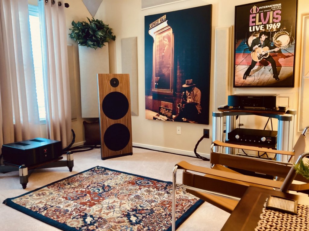

« Reply #39 on: 11 Feb 2022, 02:26 pm »
@Mr. Big, I’ve always loved the look of your setup!
