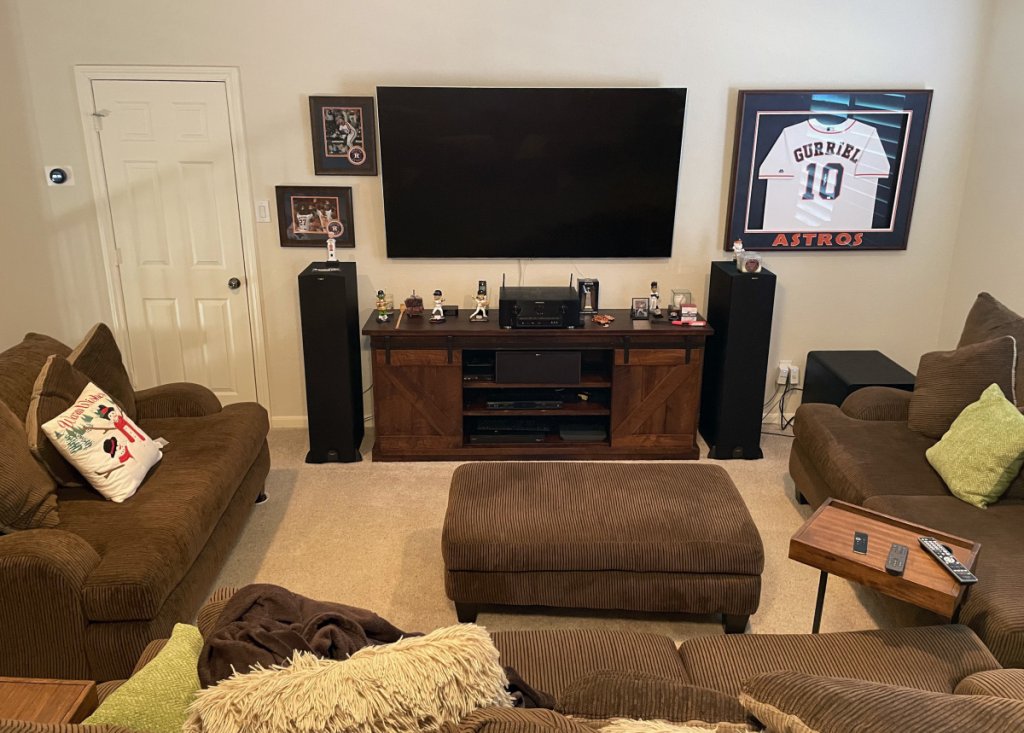

The PBs definitely have more oomph since they're ported.   I have a single PB-2000 in my game room (what used to pass as the home theater), and it does a fairly decent job.   I replaced it at one point with the dual SB-2000s, and I still thought the single ported sub sounded better.   Of course, open baffle + sealed is definitely the cat's meow.    :thumb:
Here's the "old" theater as it exists today.   PB-2000 in the right-hand corner.
EDIT:  Side note, before I get chastised for speaker placement here, it was a failed battle with the wife since she cared more about aesthetics than sound quality.   She calls this HER lounge now.    I'm just a guest in it.   :lol:
