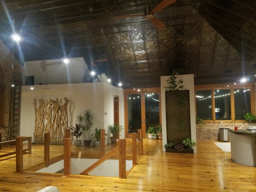

This is a new speaker location I just setup.  Everything was in the corner to the left and facing the left window.  In this new configuration I have turned the subs way up and it sounds much better without boom I was getting before when in the left corner at a lower sub output.  The subs were not moved.  I believe that the boominess was caused by the mains?  I say this because they have more output now but are in the same position.  The bottom end is so full now even at low volumes.
The room is all brick, wood, glass and tin ceiling.  It is 30' from left to right as seen in this picture.  The bell tower on the far right has 3 arched openings and is not included in this measurement.  The window is 9' 6" wide and 18' at the top.  The ceiling slopes from 11' at the edges to the flat section at 18'.  The glass at the stairwell is at 19' 6" from the brick at the gothic window.
The speakers are 11' apart and right at 4' 8" to the center of the woofer from the front wall.  The listening position is around 11' back from the speakers and they are towed in quite a bit to cross in front of my face.  There is a rather large 5' x 5' coffee table in front of the sofa.  That is not great for sound I know and something my wife wants to get rid of.  She also would prefer to move the sofa forward a bit.  Perhaps I could close the triangle down some and still be fine?
I am keen to get something like the Spatial x3, X4 or X5 in this space and would mostly maintain this same configuration.  Those have much more bass than the Abbeys but I would still think I need subs for room mode control?
James

my goodness that's a beautiful room!
mick wolfe
  • Posts: 1379
Re: No Room Treatment -- What Alternative To 4 (Multiple) Subs?
« Reply #9 on: 6 Feb 2022, 06:02 pm »
That's a beautiful space. Huge and very inviting, but I can only imagine it being very lively. Yes, you'd have to do a massive amount of passive room treatment, so I'd probably dismiss that.  Maybe try a larger, thicker area rug between the speakers and the listening position. Also, you could possibly try/audition the new Schiit 6 band tone control device. Other than that, it's on room correction devices in which I have no experience. (or interest for that matter)  Others may offer a different opinion though.

So..ummm...you live in a former church?? Amazing...

Yes, it is an old church.  8 subs would be overkill as I get plenty of output from the 4 and that is with the Abbeys that do not play that low as a 2 way.
I should have stated that the room is just over 41' x 41' with a walled area taken out for a bathroom and then an open kitchen.
As for DSP, I am really strongly considering the Lyngdorf TDAI-3400 with their Room Perfect which is said to be the very best implementation of room correction.  There is a guy on AC here that lives in Switzerland and he uses 3400 with the Spatial X3 and says it is all he could ever want or need.  Just not sure how analytical it may sound.  All reviews are top notch.
Guf -- I don't understand exactly what you are saying? By disappear do you mean properly integrate?  If so, that is not what I am talking about.  I am talking about trying to eliminate subs from a visual/architectural design aspect.
I guess my real lack of understanding is around my belief that I don't think very many people on Audio Circle and much less out there in the larger audiophile world use 3-4 subs to control room modes.  So I am trying to understand what is mostly done and what can or should be done.  Especially given my room dimensions.   Can it all be controlled with Room Perfect DSP and just mains like the X3, X4 or X5?  Or add just one Ripol or open baffle sub?  I am sure a popular answer is "You will just have to experiment" which I get but you guys have a lot of knowledge so a proper starting point and understanding of what the end may look like is a smart initial approach.
