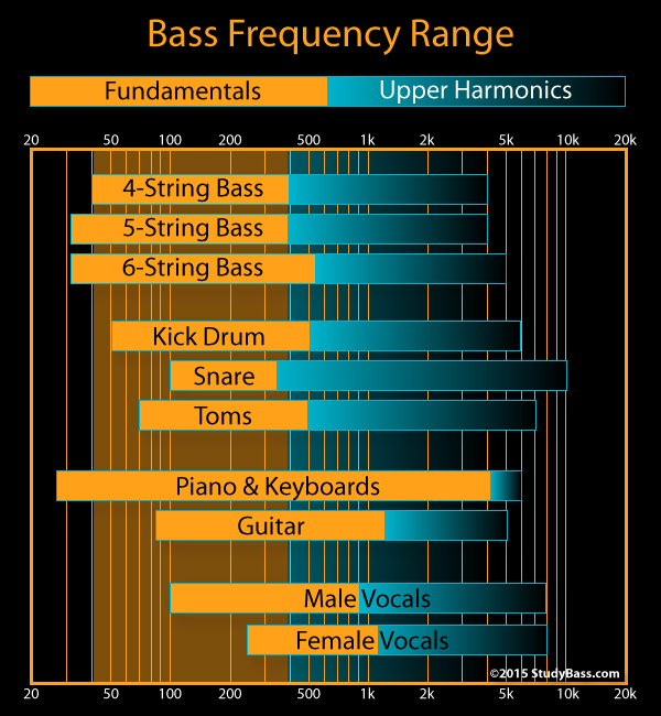

The short answer is that not all of the bass is 100Hz and below, and garbage in = garbage out. Whatever the plate amp on the X receives will be amplified, so if the system amp is slightly distorted or non-linear ≤100Hz that will be amplified.
RonN5
Re: Active bass — how does amp affect low frequencies
« Reply #5 on: 3 Feb 2022, 03:12 pm »
Building on NewZoos comments....
My opinion:  the thing about bass is that it covers a range that has both tone and physical impact...and blends right into the midbass with harmonics making them inseparable.
Presumably the onboard amp drives the lower woofer - subwoofer below 90 hz where there is some bass tone generated (but not a lot of actual tone)  by that driver.... and your own amp drives the upper driver (midwoofer) where there is a lot more bass/midbass tone generated.
I use the words "some bass tone generated" because if you have a good subwoofer and turn off your mains and start listening to the sub as you adjust the crossover from 40hz up to say 150 hz, you don't really start to hear much of what you would call tone until you get into the 60-70 hz range or higher...below that, just a lot of grunts and thuds so to speak...but important because they add the body and impact of the bass.
Therefore, your amp driving from 90hz up has a big impact on tone while changing the onboard amp driving the 90hz and down would have a very small impact on tone.

Overtones from the bass notes are reproduced in the midrange speaker so I would think the amp driving the midrange (and tweeter speaker) has some influence on the tonality of those bass notes played from the subwoofer.
