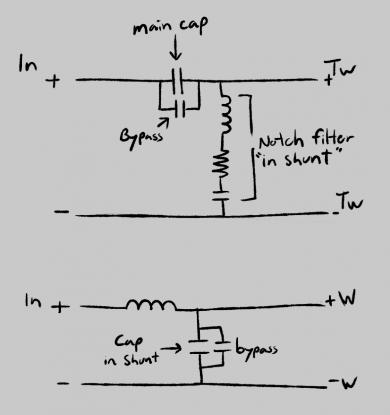

Hobbsmeerkat
  • Posts: 2741
Re: How to Tell How Many Bypass Caps are Needed?
« Reply #4 on: 1 Feb 2022, 04:10 am »
Its easiest to tell when looking at a schematic.
Heres a basic one I sketched up:
You're most likely to see a capacitor in shunt on mid/bass circuit.
They are designed to pull down the top end of the woofer faster than an inductor alone. They tend to be the larger caps in the circuit. Thought not always.
In a tweeter circuit, about the only time you will see a cap in shunt will be a smaller value than the main caps in line with an inductor and resistor
