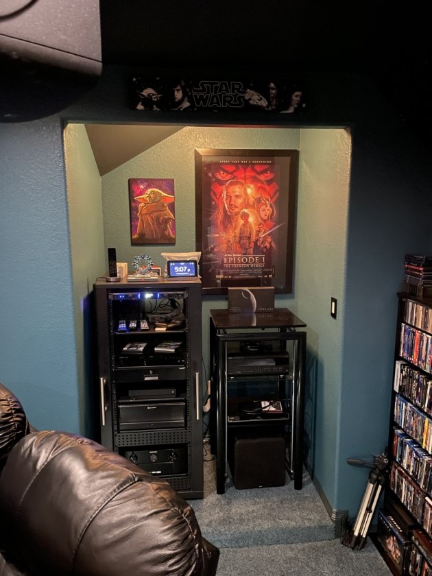

I have a single PB-2000 in my game room that used to be my primary theater.   But then I built a dedicated room and initially had a pair of SB-2000 Pros in there, but there was something about them that didn't seem to do it for me.   So I put one of them at the back of the theater and built a pair of open-baffle subs from GR Research at the front of the theater.   Now it's phenomenal.   :thumb:
Before:
After:
