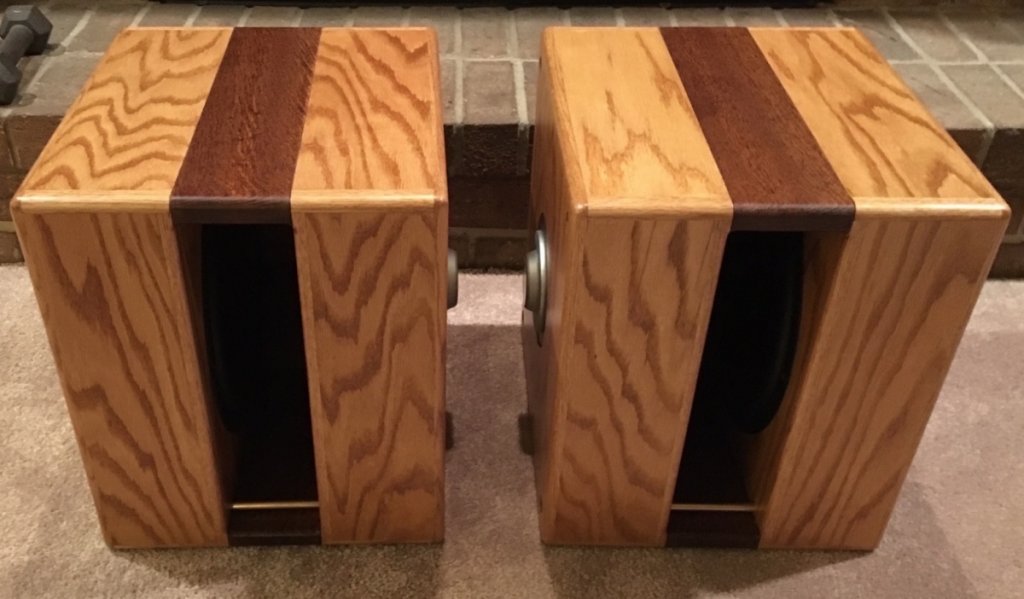

Those Modal Acustik subs are really sexy looking.  I have a pretty good idea of how they sound because I use a pair of similar Ripole subs in my system.
They do not have the classic figure-8 radiation pattern of a true dipole, though.  Rather; their pattern is a cardioid with an off- axis null, a large front lobe and a slightly smaller rear lobe.  And they can play much lower than a typical OB dipole because the air mass in the chambers reduce the woofers' resonance frequency (fs) by about 10Hz.
My Ripole subs sound fantastically good:  Their notes just seem to rise up from nowhere and recede back to nowhere-- non-boomy and very, very clean.  I think conventional subs are better for home theater effects and Ripoles are much better for music.  I will never go back to conventional subs!
Mine are shown below:
