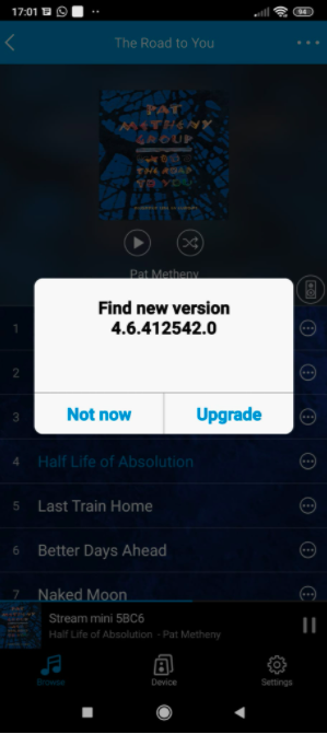

what does the new firmware on omnia stream dac correct? .....
I haven't downloaded it yet .....
rustydoglim
Re: Omni’s stream mini
« Reply #18 on: 12 May 2022, 11:43 am »
It fixed the gapless playback problem (meaning it can now do gapless playback).
The firmware update is only available for Stream Mini and Stream Mini DAC.  Still working on the firmware for A300, A300SE, A200 and Stream-9.
Westerwälder
  • Posts: 61
« Reply #19 on: 12 May 2022, 03:24 pm »
Nuprime Audio FR has confirmed on Facebook the update also for the WR-1:
"An upgrade is proposed since a few days, on our models NuPrime WR-1, Omnia A200, Omnia A300, Omnia Stream Mini and Omnia Stream Mini DAC."
Is that possible?
