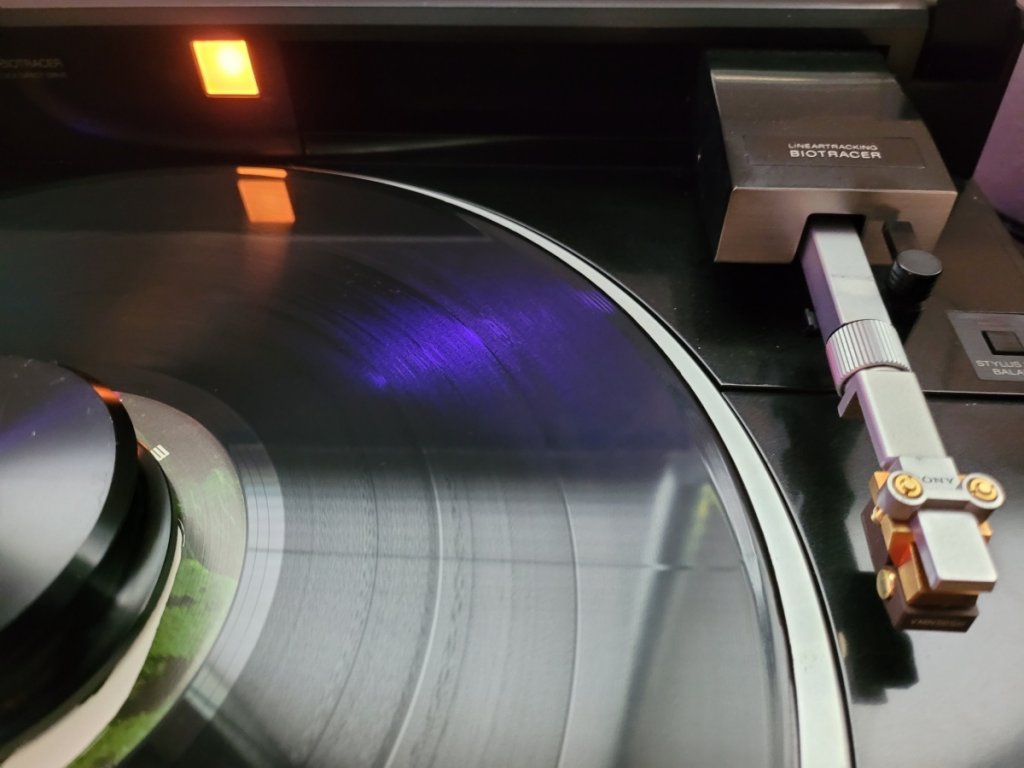

Hi guys,
I bought this PS555ES for a song and a dance!
Boy, was I tired after dancing! haha...
Anyway - This turntable tracks like a high-end transport!
I've measured over 115 dB of 25-80 Hz low-end (at the seating areas,) with this thing not flinching (I had problems before, then I removed the dust cover while listening and *poof* the resonance/feedback disappeared.)
I mated it to an AT 750SH.
It sounds good!
Does anyone else have experience with BioTracers? Your thoughts?
