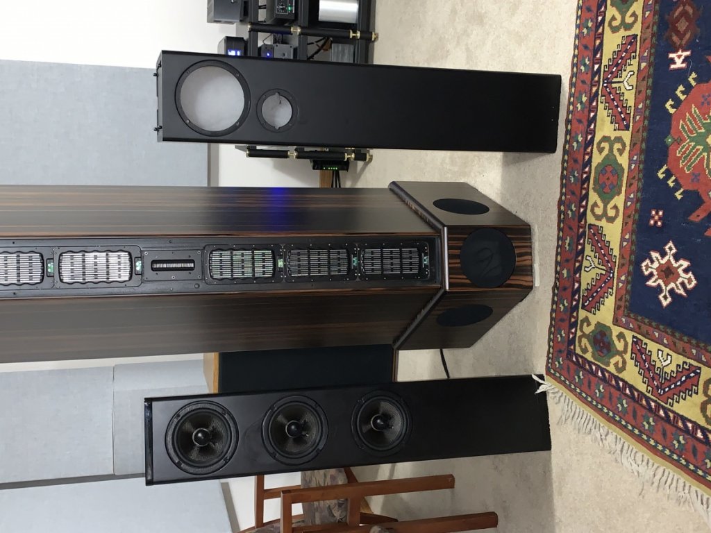

So I resolved to doing an experiment of changing out the bass section. Design constraints were working in same range of 70Hz to 230Hz with same passive XO or active XO (which I use), and not take a large footprint as there is limited space with the V-60 and two large subs. I looked at open baffle U designs as they should pair well with the di-pole midrange. The problems encountered is to get to 70Hz you need larger drivers (footprint gets big fast) and getting the SPL to match the midrange would be a challenge. So a more conventional design was chosen.  So I started sketching out a design, but saw a pair of speakers for sale locally that where pretty much already what I was thinking. The Definitive Audio BP-10B was a 8”X12’X43”, with 1” front and rear MDF and ¾” on sides, a little over 60 pounds and the 6.5” Misco drivers we use would drop in. Since it bi-polar design it has MDF separating the front and back running through the middle of speaker so nice and tight cabinet. $200 for an experiment was all I needed as I could always gift them to somebody. Plan was to try them out before cutting them up, if positive results add a couple 6.5” holes for drivers.
So onward with the experiment. Removed XO threw the Misco drivers in front and rear wired in bi-pole (both speakers in phase as opposed to di-pole (out of phase)).  Was able to get close to comparable SPL’s from stock bass section with only two drivers by adjusting gain on active XO. It was clear and obvious that this solved the issue I was trying to resolve. This is a big upgrade IMO.
I am in the next phase of plugging tweeter holes, and adding two more 6.5” holes spaced 9” from centers.  Analysis hook up wire is on order and will configure same as stock bass section of one driver in parallel with two series drivers. I am not going to plug the rear speaker hole, but will have a plate. I am going to try adding a rear speaker and configuring in di-pole and bi-pole configuration to hear what happens as I think that would pair well with the di-pole midrange. On cosmetics, not sure if I will cover with sock, or have drivers exposed, or veneer with Macassar ebony…. all things down the line.

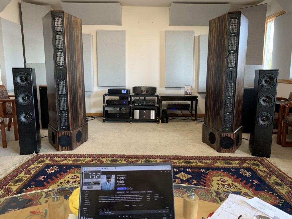

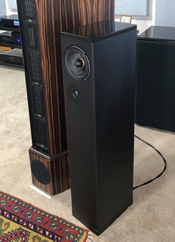

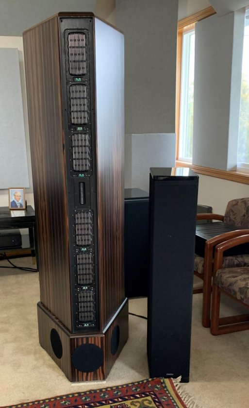

Completed modifying the cabinets. Woodworking is not really my forte, but they came out nice. Those four tweeter plugs took some time. It would of been fine leaving the tweeters in disconnected to fill the holes, but knowing me seeing them would likely have driven me to madness over time. Definitely resolved a design challenge for this particular speaker that bothered me. Really pleased I was able to correct.
Have not plugged the rear 6.5" driver hole, just have a driver stuck in there. Drivers are configured as the speakers were designed. Plan to experiment by adding rear facing driver and configure as di-pole and bi-pole to see how it pairs with the di-pole mid range. From there either plug hole or keep rear firing driver. For now just want to enjoy the fruits of the past few days of work.

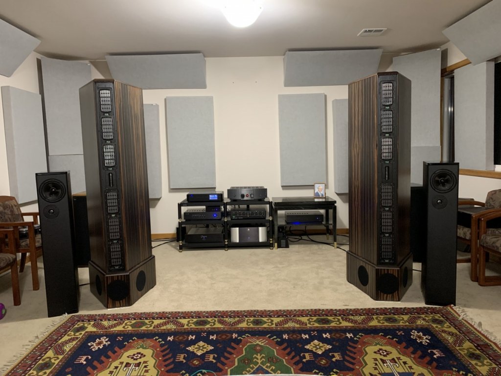

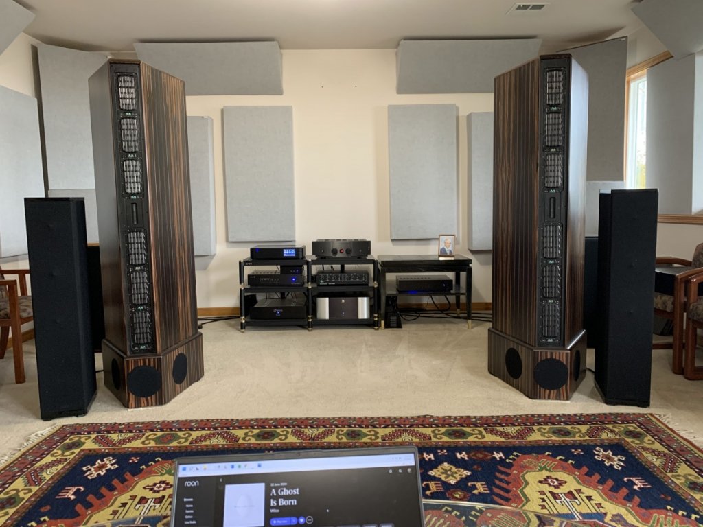

So after experimenting with four misco drivers in various configurations, I found the best configuration was as Brian designed three drivers; one driver in parallel with two series drivers. That gave me the most SPL and allowed me to keep within the design constraints of using passive XO and still be integrated with mids/tweets.
Hiccups. After committing to configuration and wiring up with Analysis Plus hookup wire, I found a channel was 4 dB down. After checking the configuration, driver polarity and SPL of individual drivers determined nothing was wrong with speakers. Troubleshot issue to active XO which had a defective Op amp. That issue really got me chasing my tail as it seemed it had to be the speakers. Not sure how long it has been that way nor how we got by before Room EQ Wizard (REW).
Bass speakers do not need to be close to ear level like tweeters, but just not on the floor. Understood Brian had only so much room with six ribbon panels per speaker. This is a worthwhile modification as it resolves a design compromise as the soundstage in the vertical is no longer compressed. More work than I thought, but real happy with outcome.
