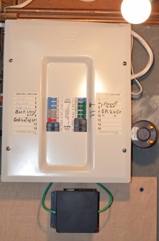

i installed the EP-2050 right where the power comes into the box and also added a EP ground filter.
the picture will show the 2050 on the lower part of the panel but had electrician move it to where the power first comes into the panel.
Also some EP receptacle boxes forget what they are called.
basically created a bubble within a bubble type protection.
And to top it off I have two Torus 240v.
this has been in house since 07 I believe and no problems as of yet.
all 10awg wiring and 8awg for the two Torus
