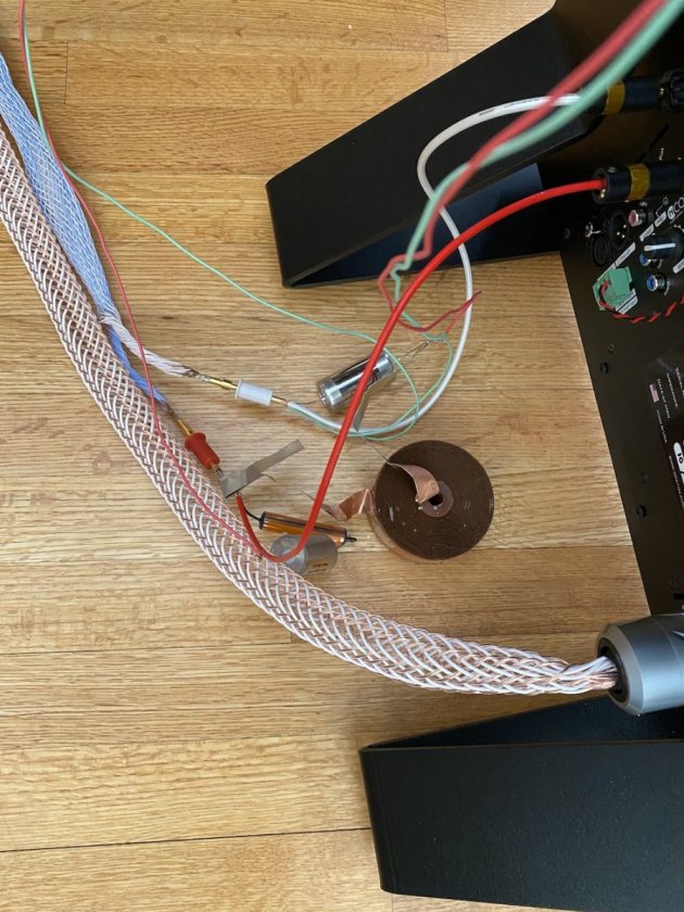

First, I will make both caps for the midrange and the tweeter Vcap ODAMs.  In the original crossover, only the tweeter has an ODAM.  And I’ll be changing out the existing Dueland hookup wire for the VH Audio OCC pure copper hookup wire.  I’ll be upgrading the existing air core inductor to a UPOCC foil/wax inductor by Jantzen.  And last but not least I’ll be updating the Mills resistor with a pure copper Path Audio resistor.
I’ll listen to it like that for a while and get a feel for the speaker before making any other changes.
Second, I will bypass the midrange cap with a Duelund copper film capacitor and bypass the tweeter cap with a Duelund copper film capacitor.
I’ll listen to this for a while to get an idea of the overall sound quality.
Third, I’ll remove the Duelund copper bypass caps and replace them with Duelund silver film bypass caps.  And I’ll also remove the VH Audio UPOCC copper hookup wire and replace it with Nimak pure silver dead annealed wire hand-polished with beeswax.
I’ll let this run for a while and then decide if I like the all copper or the all-silver with the X3’s.  Should be fun!!

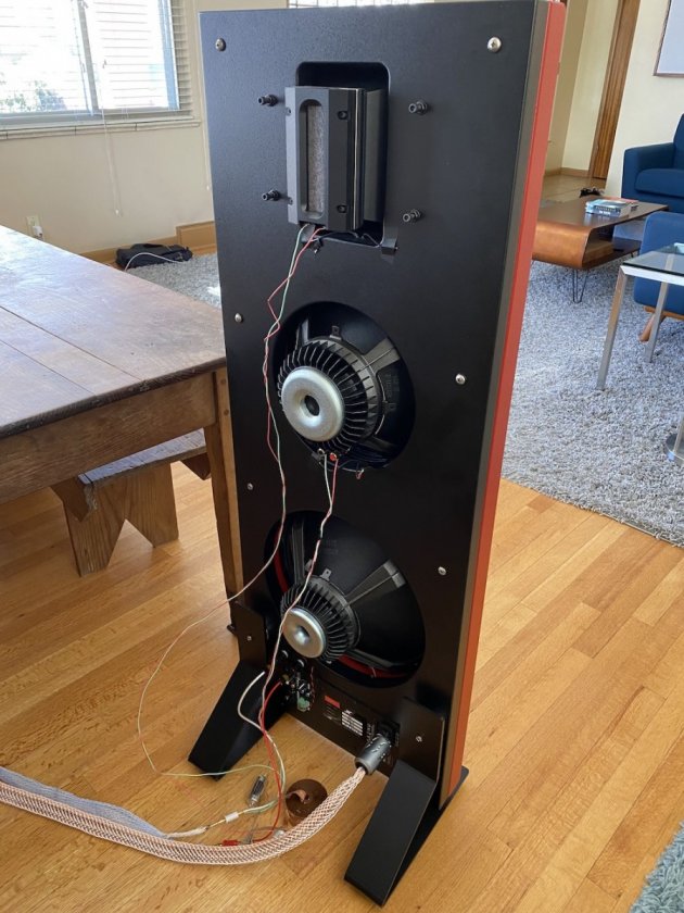

Initial Setup
Here's the initial setup, I've not done a neat job with it because I'll be rewiring a bunch of stuff and swapping out several parts before I tidy up the work and make it look nice:
