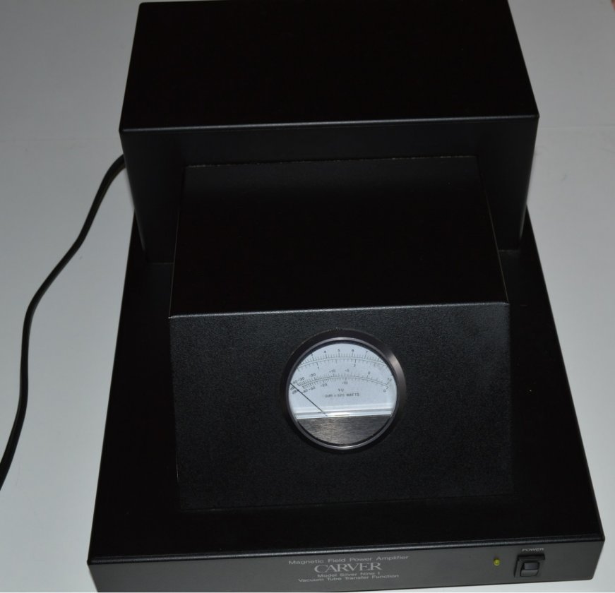

« Reply #4 on: 9 Jan 2022, 04:24 pm »
No too expensive.
I have sold a Silver 9T for less that it.
or  I loss money ?
