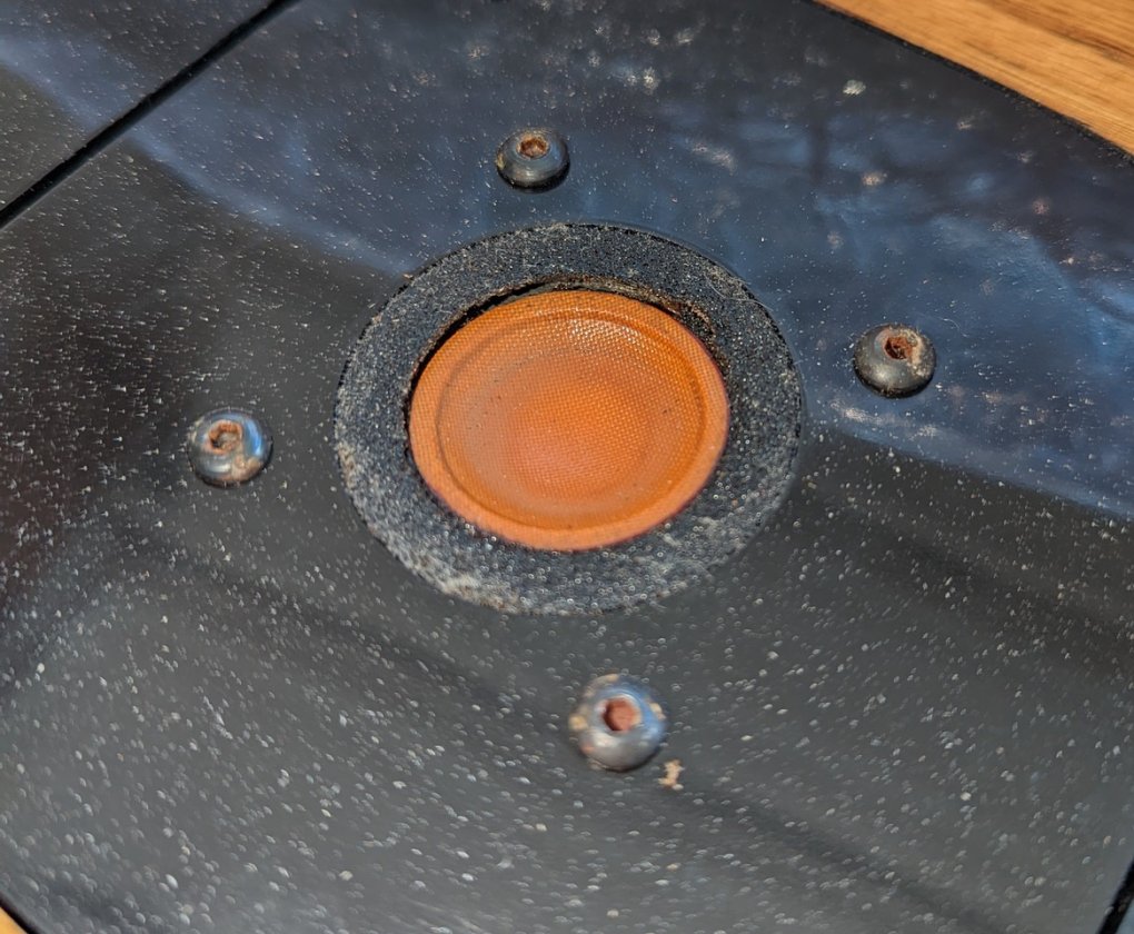

1. Surround on the Focal T120 tweeter (the yellowish fiberglass one is what Brian used I think)
2. One Focal T120 tweeter is discolored (what does this mean?) It's next to the one with the tear in the surrround

He also mentioned that the slightly darker T120 tweeter may be the Kevlar model, perhaps replaced at some point from the normal fiberglass models. Any commnents?

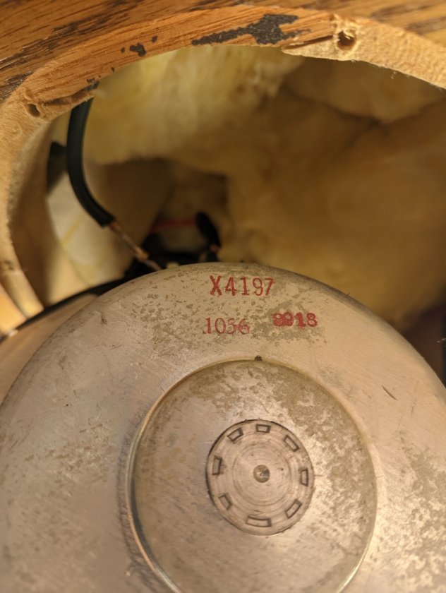

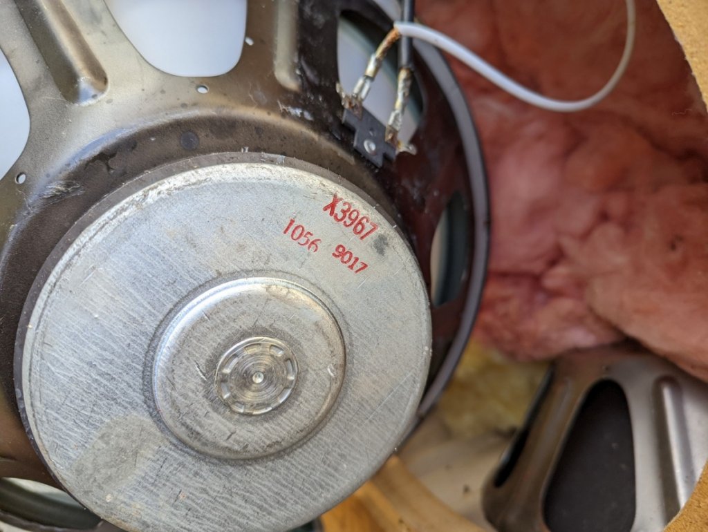

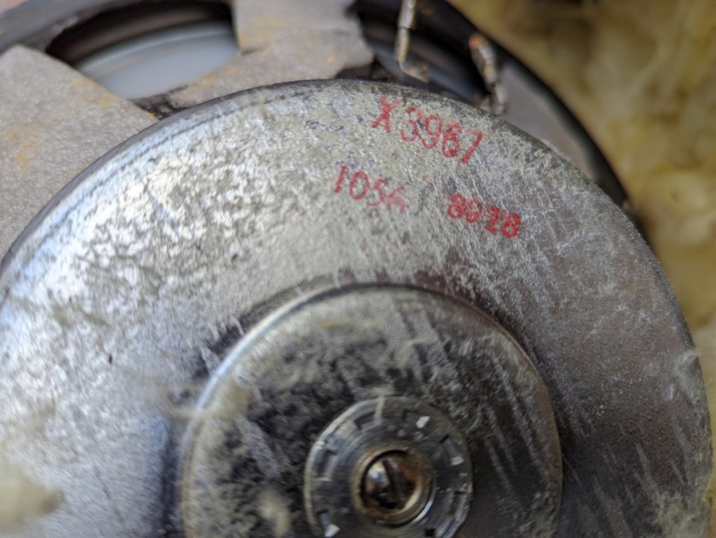

So, how many of you knew that one of the model numbers on the back of the woofers indicated the manufacturer?
And, how many of you knew that one of the number codes on the back of the woofer indicate the week and year of manufacture?
1056 designates Gefco as the woofer manufacturer. All mine are 1056. Apparently, Gefco was eventually purchased by Fisher (whom I guess way back was considered a quality company) , and then eventually they went out of business.
I will ask him if he knows codes for other manufacturers as well. I guess this was primarily for woofers and usually only for American companies.

For the T120's, replacement surrounds are apparently made by one company only. They are in the Netherlands and have eBay ads and YouTube videos. Called Audiofriends. The surround replacement looks doable by myself, but tedious. I decided to let Speaker Repair Pros do that to for $65 each.

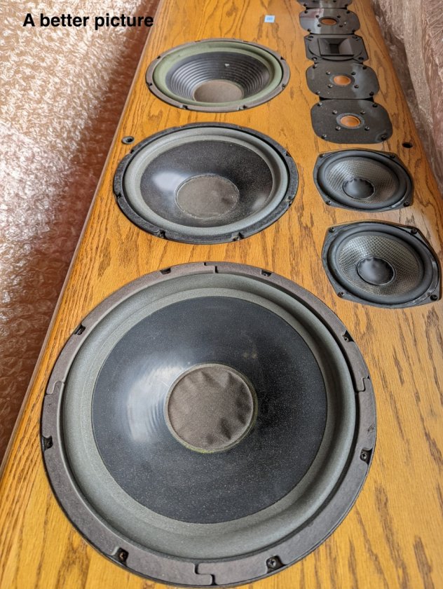

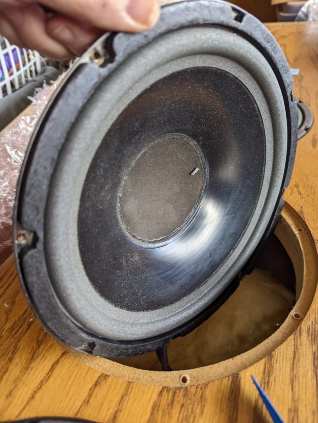

Here's some pics of the surrounds of the T120 tweeters, and the front and back of the woofers.
Any idea why the color of the T120 diaphragm to the left is different? It's the only one like that. All the others are the same.
Anybody know who the manufacture is of the CF midranges?

back of upper 10", this is the one I'm replacing the surround

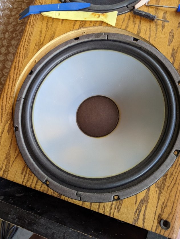

front of lower 10", crushed center cap which I should be able to pop out easy
back of lower 10"
Big list of speaker codes on Audiokarma.org https://audiokarma.org/forums/index.php?threads/speaker-manuf-eia-codes-the-big-list.491925/
