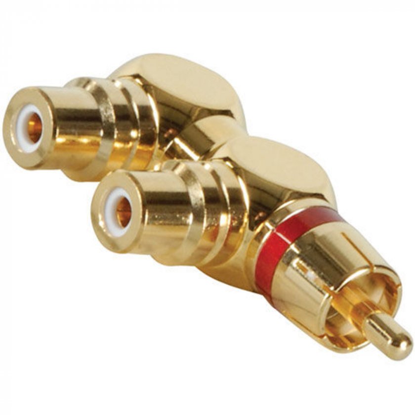

-Dieter, thanks very much for that information. You are correct that I will be using the SVS Micro 3000. I actually have a pair of AudioQuest splitters, a syou show in the phot being delivered tomorrow. I will give them a shot given the issues you have pointed out concerning using speaker level connections. Especially as I am using a tube amp.

I spoke at length to SVS and they were extremely helpful. They even looked up the manual for my Conrad Johnson preamp. They informed me that using the second audio output and connecting that to the audio input connections at the sub were definitely the way to go. Just need to locate a pair of interconnects of sufficient length now,

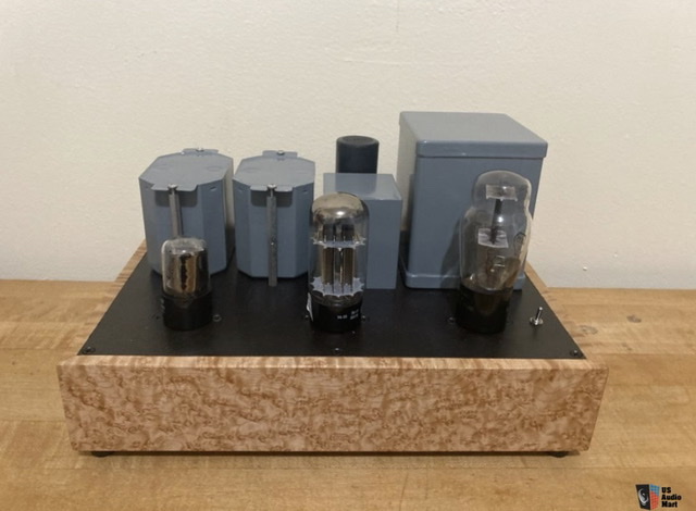

Check with the builder first to see if this is okay, some tube amps like Decware SE need a jumper for the black wire to both negative posts to eliminate hum.
Do not do this to any amp without checking if this okay and will not damage the amplifier.
