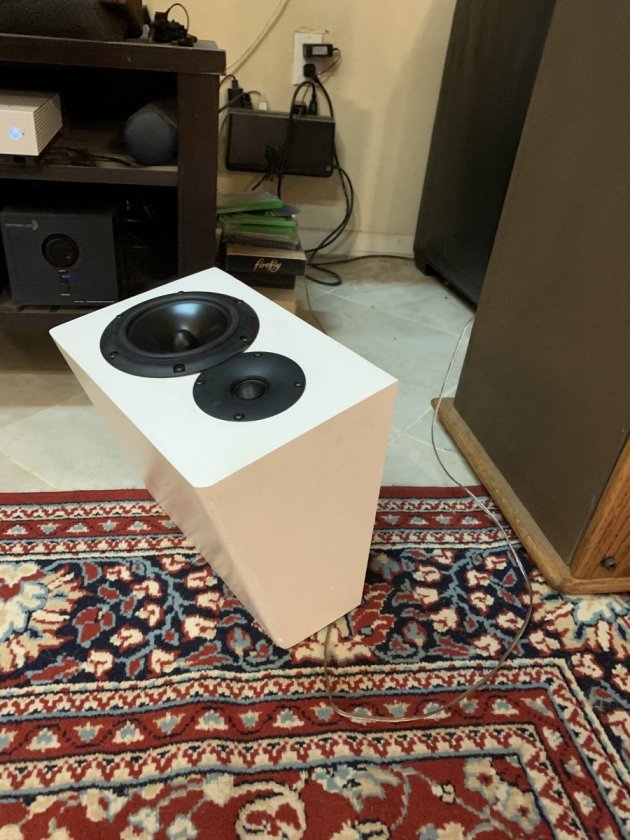

Not built a cross over circuit before…
The parts were all there … just not labeled & no pictures with th3 parts list…
Confused the 2k resistor with the 0.2uF caps
Anyway… built it and both the drivers make noise….
Not sure if my photos are clear enough to tell if I screwed up… limit mount  oars to 4” wide … size of woofer mount hole.
Overhead view
Side view…
Cup connects on left… drivers on right.
Used one wire nut where 3 wires connected.  Devised a better way… though I think wire nuts make a very good connection.

The design may have changed slightly if you just got your kits since they're supposedly using an updated tweeter.   Mine are the earlier kits which match the video posted (which I didn't know existed until now).   Here are my completed crossovers for comparison.

Nice build… they’re pretty… took me by the 3rd board to realize putting connections on the board was stupid & to just wire directly to the cup & drivers.

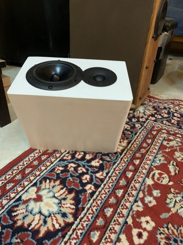

Finished my AV-1RS build. Sound good. Decent pair of bookshelf speakers by themselves. I replaced my X-Statiks with these for a bit of listening. Wasn’t horrible… not near the fullness or frequency range… but crisp & clear… a little bright.
I used the flat packs for cabinets… beautiful job.  Glue up real easy.
Used no res inside… makes fitting the crossover a bit tight…
Tried to keep the coils away from the m130 magnet.
Paint with a brush.
Used ‘sanding sealer’ then latex primer. 2 coats of Sherwin Williams best trim paint.
Sand between each coat. & with final coat touch tip of brush in water & bush over… thins the paint so no brush marks. No finish or sealer. I’m treating the speakers as a bit of room trim.
A little bright would be an understatement if listening to them on axis. The tweeter level is about 5db louder than the woofer if you are sitting in front of them.
For the frequency response to be balanced you have to be below the driver level and the highs are attenuated by reflecting off of the wall and ceiling.

« Reply #9 on: 14 Jan 2022, 02:51 pm »
Yes, of course Danny is correct.
I got the speakers mounted on front wall…
Then configured AV receiver for the as speakers B
I could then switch back & forth between the. X-Statiks & AV 1RS’
Pretty dramatic.
Interestingly, when on the floor as A speakers… when listening in Dolby ATMOS mode… very little difference… demonstrating how heavily the center speaker is weighted in surround sound.
