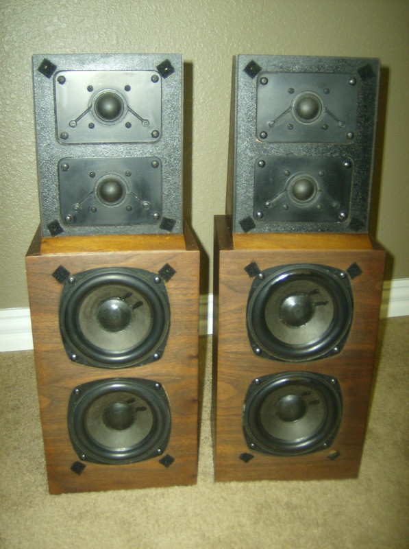

Just as an aside, I don't mind tweaking, and looks don't bother me much. So sticking a number of felt strips on the baffle, even though it'd look bad, won't bother me in the slightest. Ditto for various DIY panels all over the walls. I'm all about the sound. I'll admit, one of the things that made me jump for these is their potential to play loud. I like loud, as long as it's clean.
To answer another question- I don't mind wall mounting them, and that is still an option, but that way they'll be even closer to the wall, hence me building (or I should say modifying) the stands I am busy with. I can build wall-mounted shelves that could push them far out into the room (as much as 1ft to 1.5ft if need be), but will this not be a unstable mount? The stands will be super heavy, and I am going to put them on spikes, which will in turn be put on metal plates, which will in turn rest on anti-vibration pads, like the one in the pic below. Ditto for my sub. This is to isolate the room from the vibrational energy of the speakers and the subs.
Anyway, enough of my prattling. Thanks again to all the guys who took the time to repond.
Deon
PS. I have some decent headphones (Grado SR125), but prefer the impact and presentation of speakers. Phones can often sound too 'on top of me'. I use them a lot, but when I wanna rock out, speakers are the way to go.
PPS. Please forgive any silly spelling mistakes. I am typing responses on my phone, as I am visiting my brother and family for the holidays and I am far from my PC. Therefore there can be some very silly spelling errors that I don't pick up even after proofreading the typed text.
PPPS. For those who want to read a bit more about these speakers, here is a link to a PDF. It is missing the 2nd page, but it has enough info to get an idea. Interestingly, the Volkswoofer that sold with these had a 12" motional feedback woofer. Here is the link:
