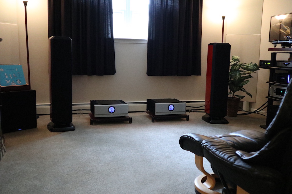

Michael, ideally corner bass trapping should go floor to ceiling. Note mine behind my Revel's .....
I agree. However, my wife has wall/window ornaments approximately 2 1/2 feet above the tops of my traps. I've thought about placing a pillow atop each trap; raising the traps several inches like you have done, or placing a 2'x2' diffusion/absorption acoustic treatment on top - something like this: https://www.amazon.com/Pack-Absorption-Diffuse-19-7x19-7x4-Absorption-Reflection/dp/B07MD9DRZP/?_encoding=UTF8&pd_rd_w=Cr0PA&pf_rd_p=29505bbf-38bd-47ef-8224-a5dd0cda2bae&pf_rd_r=B7K1Z6C150W3MFNZ68K6&pd_rd_r=aa35b741-c75a-425b-8881-59332ba64b75&pd_rd_wg=ORT57&ref_=pd_gw_ci_mcx_mr_hp_atf_m
Nice looking amps you've got there!  :drool:
Yes that is another option as well. Tim's post spelled out some good advice on taking it one-step-at-a-time ! Another area, depending again how close your speakers are to side walls, is first point of reflection. 2" thick absorption is ideal for that application
