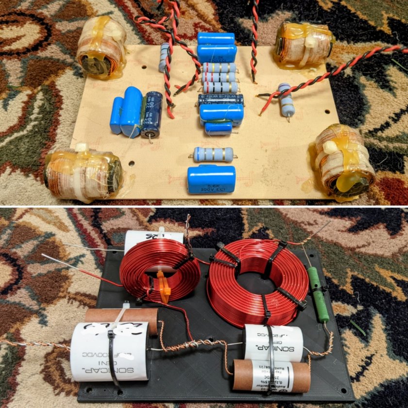

Spent the next couple days disassembling the speakers, designing a crossover board for it and putting the boards together.
The customer wanted top-level parts for the upgrade so thats why it includes miflex caps.
The new board is actually larger than the original, and only just fits into the woofer hole... With maybe 1/4 inch to spare... Fits onto the same place the stock board did. I used a combination of 3M "heavy duty" adhesive strips and a single screw I placed in the middle of the board to secure it to the cabinet.

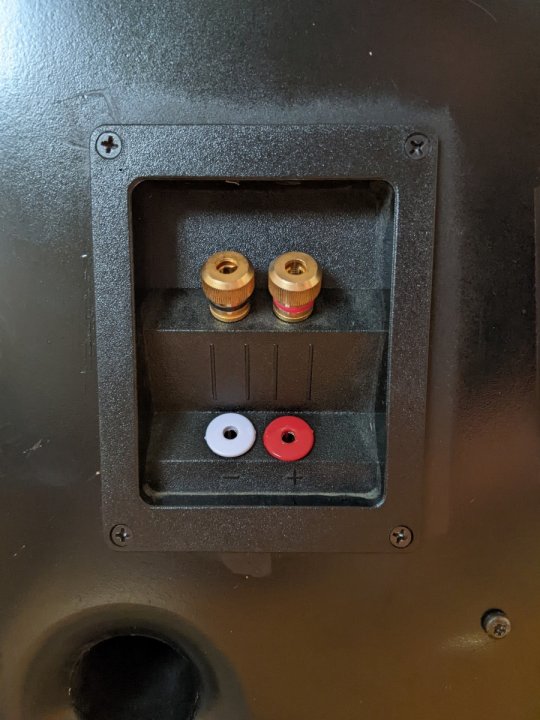

Order: binding post > tube connector > crossover so the binding post connection doesn't interfere with the tube connectors connection.

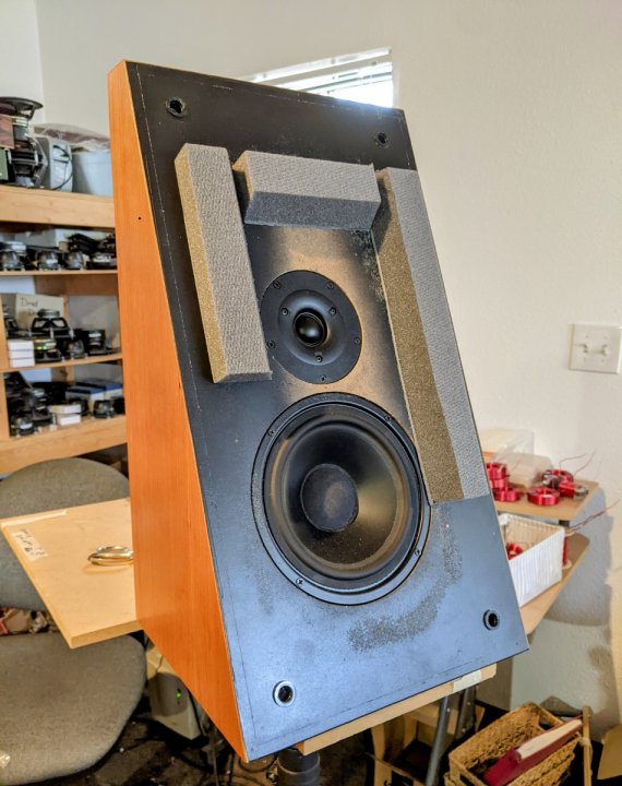

I have some butyl damping material I used for the stamped-steel frames and that really quieted them down, and did the same for the long ports in the cabinet
I then pulled out the remaining stock insulation and lined them with norez. Added some polyfill to the upper secition and put the stock felt stuffing back over the crossover.
Attached the drivers and put them back up on the stands for some more listening.
WOW. These things really came to life.. you would bever know that they were the same speaker.. they no longer sound anything like they used to. All of the lost details were present and everything was focused and clear, right where it should be. I listened to them for maybe about 2 hours? They were a lot more fun than they were before the upgrade.
Getting rid of the felt on their baffle also really improved their overall soundstage presentation.
I'm really impressed how they turned out.

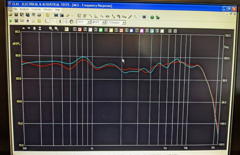

This is what we found worked best with the NoRez on the outer face to allow the speaker to work with the grill.
Here are the measurements with the grill before the norez (green) and after (Red)

During the lockdowns of 2020 upgraded the crossovers with good quality components, duplicating the John Bau design with a small tweak to increase the tweeter output.  The original crossovers were on a double sided board with heavy and wide paths, different than the picture shared by Hobbs.  After the upgrades separation of notes clearly improved.  Vocals better, able to hear small details previously just not audible.  The final icing was to raise the back of the speaker about 1/2 inch, tilting forward a little.  The high end simply sparkled.
In XSim the original circuit with my small tweak showed a frequency response +/- 2dB from 100 Hz to 20KHz.  Of course, XSim only works with component values and speaker parameters, not considering quality.  In room measurement with REW showed +/- 3dB from 200 Hz to 16KHz.  Just for fun tried an 8 component crossover in XSim.  Virtually the same FR as the original John Bau design with tweeter polarity reversed.
No doubt better quality components make an audible difference, even if an FR plot does not reveal any difference.  Eager to see the cost of Danny's 6 component crossover design.  Might have to start another project.

Here are some REW measurements of Spica TC-60 in stock condition, after crossover component upgrades, after tweeter ferrofluid refresh.  REW measurements taken in my listening room under as identical conditions possible.  Not an REW expert, so welcome thoughts or advice from more experienced users.  For all graphs 4ms window, 1/3 smoothing.
TC60 in stock condition.  High end starts dropping above 4K.
October 2021 TC60 after crossover mods. Duplicated original crossover with higher quality parts.  Changed 1 resistor value to increase tweeter output.
April 2022 after tweeter ferrofluid refresh.  Might need to go back to the stock resistor value previously changed.  Although with seasoned citizen ears, the high end sounds pretty good.
