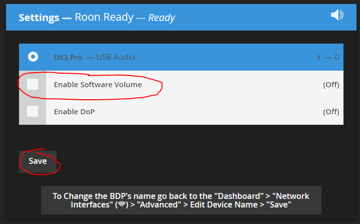

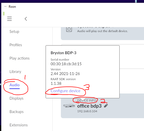

Hi Northman,
You can enable software control in the advance roon ready settings
Chris

Chris, thank you SO MUCH. I never would have figured that out. This is not the first time you've rescued me--and I truly appreciate it. Once again I'm deeply impressed with the support that Bryston offers. And thanks as well to James and to jobiwon!
