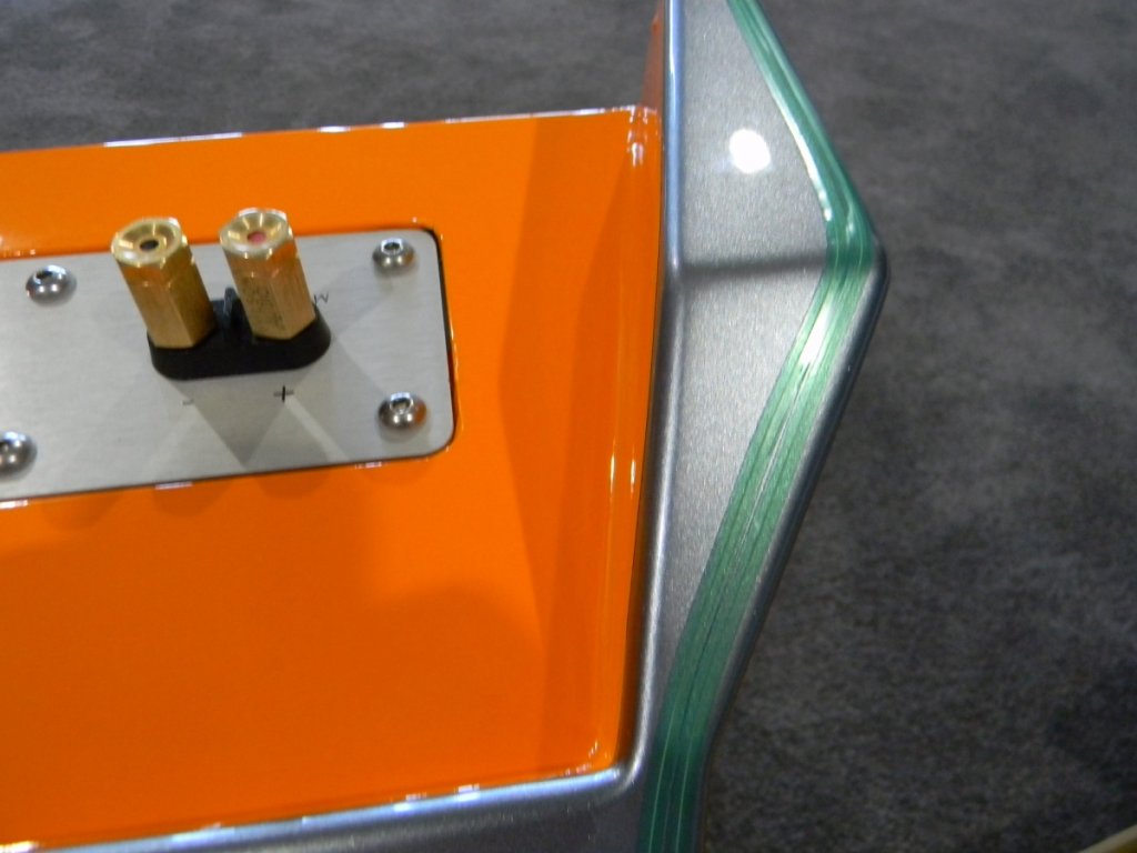

Compound curves. Ugh.

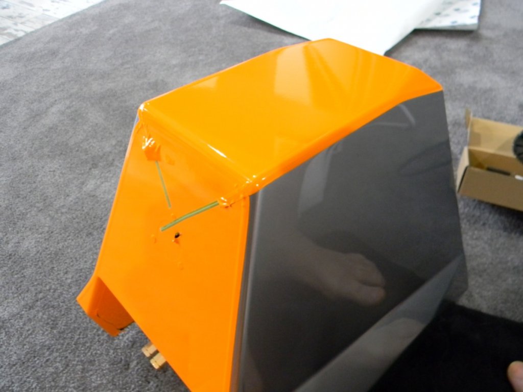

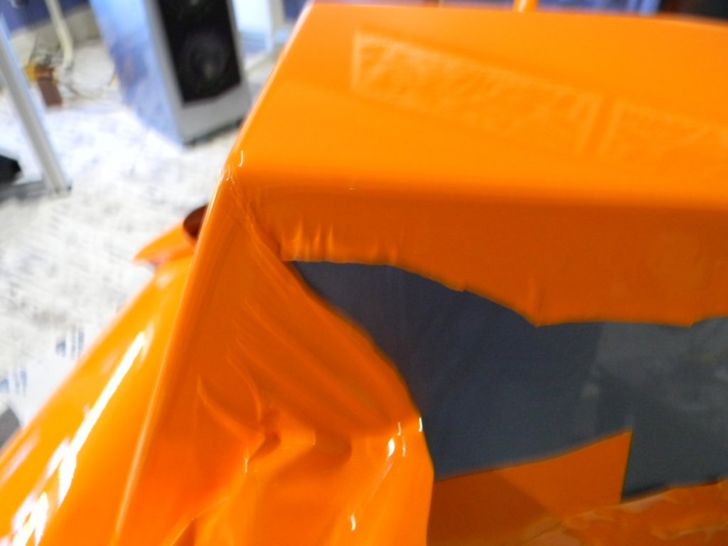

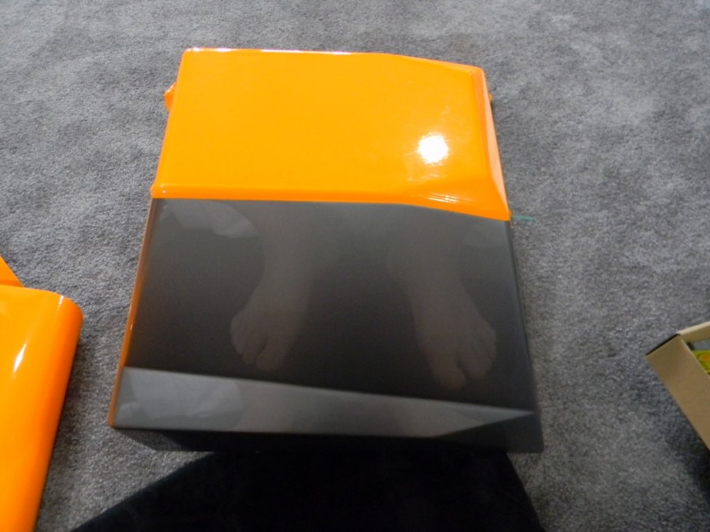

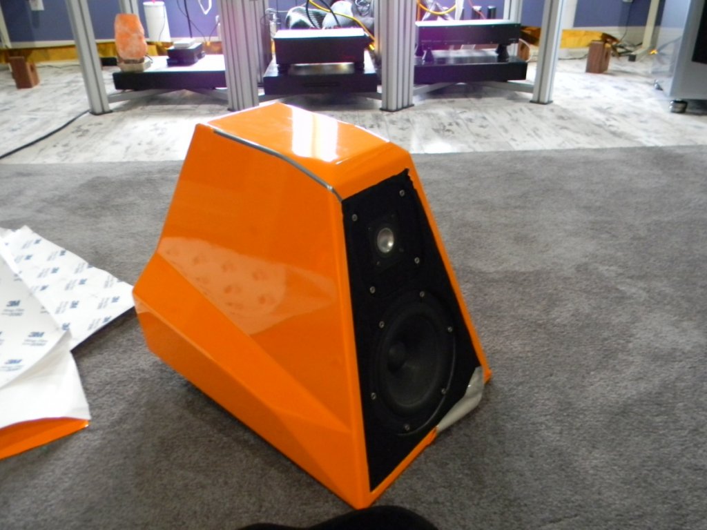

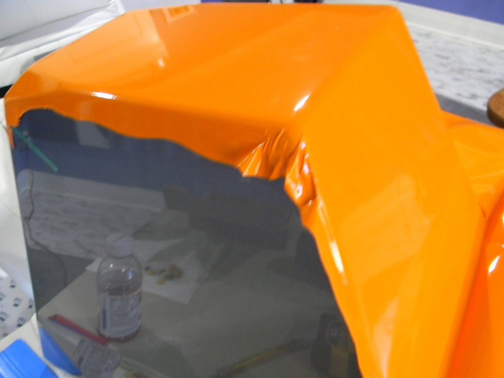

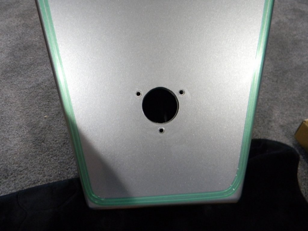

I came closer the first time I tried this in the summer. I had a trim line failure and it left a gap I could not go back and fill. So I tried it again last week and failed even more miserably trying to get the vinyl to round 3 edges simultaneously. You can only stretch the vinyl so much with a heat gun.
A bunch of pics to show what almost happened. Oh well.
Three local vinyl shops refused to attempt this but I gave it a shot anyways.
Ran into issues with these corners:

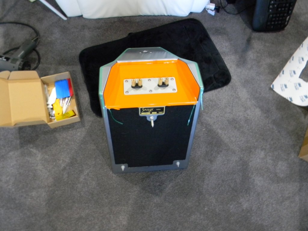

I hung it up. The tops of these are constantly changing shape and as a novice first time user of vinyl on these geometries I gave on the first attempt this summer. Then I got to thinking I cannot be defeated so I tried again last week and failed even worse. Handling the bottoms would have been difficult but the surfaces are more square so they might have been easier to complete. I started with the hardest piece - the top. The good thing about vinyl is you just pull it off, especially a smooth painted surface on the Wilsons.
I'm still not happy I could not make this happen. :roll:

The trim tape you put down first has to be planned properly so you can pull out the doubling of any overlapping vinyl sections. Unfortunately, the tight radii and in some cases the need to have parallel trim tapes applied make it very tricky. A car is so much larger and more forgiving.
And yes, maybe I'm too much of a perfectionist....
