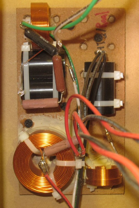

Salk Sound uses good parts
Can't see the brand names......
WGH
Re: Which manufacturers uses good parts?
« Reply #6 on: 20 Nov 2021, 11:37 pm »
The resistors are Mills, I erased the values. People will have to guess about the other parts but they look nice. The caps are mounted upside down to deter snooping. In 2014 Jim posted that Solen is the standard cap. The inductors are nice and shiny.
We do cap upgrades for customers all the time.  When we finish a pair of speakers with upgraded caps, if we have an identical pair with our standard Solen caps, I always like to do an A/B comparison (as we did in this case).
When I first hear the speakers with the upgraded caps, I get a sense that the treble is a bit more transparent.  So my first reaction is that there is a difference (of course, I know which caps are in which speaker, so this is not a legitimate test).
Later, I usually have someone switch back and forth between the speakers without telling me which pair is playing.  I then try and see if I can tell which is which.  Here's where it gets a little murky.  I find that I can correctly identify which speaker is playing about 50% of the time - no better than a simple guess.
- Jim
Best call Jim if you really want to know.

Danny Richie
« Reply #10 on: 22 Nov 2021, 02:26 pm »
The Mills resistors are top level resistors, the rest are budget level parts. The inductors are Zantsen. The reason they are less expensive than other inductors is because they are made from recycled Copper. The Solen poly caps are a good budget level cap. We use some of them in our budget level or base level kits. The wiring looks like PVC jacketed wire. So nothing real cheesy, good, but not great.
« Reply #19 on: 4 Jan 2022, 03:53 am »
Thank you Danny, now I won’t have to call salk to find out what the parts are on that x-over. Thanks Danny for your honesty!
WGH, the secret parts are no longer a damn secret.
