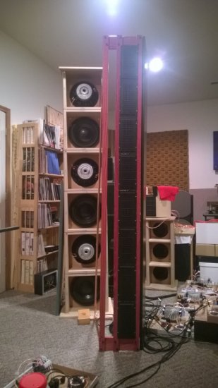

I believe this has already been done a few times. Most that I've seen have included modular single woofer boxes in a (6) stack on each side, and they use the Rythmik HX800 amps (1 amp per 6 woofers, 2 amps in total)
Below is a photo from one of HAL's systems. I saw this in a thread a while back, and stole it from his gallery.
HAL - if you'd like me to delete this picture, please let me know! Don't mean to overstep by posting one of your pictures!

No problem with using the picture of the modular 6x12's.  Captainhemo still had some modules last I talked to him.
I did change to 2xHX300 servo amps per 6x12.  I needed more upper bandwidth than the HX800 gave.  Also gives flexibility if I wanted to split them into 4-3x12's.
