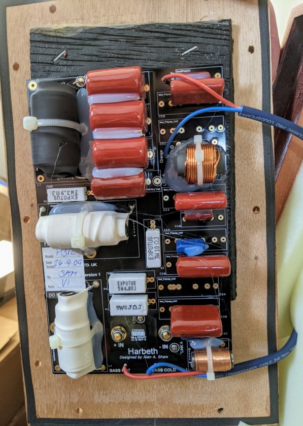

Here's the picture i took that Danny used in the video:
Its not the worst crossover we've seen, but its far from great.
There's a fair bit of performance left on the table, but there's just no room left within the speaker for a custom crossover.

Can you read one of the module numbers of the capacitors off as text in this thread, Hobbs?
Depending on the module of the capacitor they're either not very good, or actually really nice at low price. The sandcasts are inductive so you that Mills etc always better, and the inductors depend on the usage but generally speaking just are not air core inductor quality (there can be times they make sense to use).
The capacitors will determine whether or not I'd say it's a bad crossover or a decent/good crossover... either way their implementation isn't bad per se, as we know it isn't a company that is plain old foolish. And there's always a chance for better parts  :wink:

It's really kind of sad.  There's not a single component on that board I would choose to use on a modern speaker build.  The stuff I used 32 years ago was considerably better quality (IMHO of course).  At some level everything affects sound....most Harbeth owners are certainly at that level, or are trying to be (hidden components that are below the level they should be don't help).  How would you feel if you bought a Ferrari that you later found out had a motor sourced from Kia?
However good the current speakers sound, they would certainly sound even better without significantly altering the tonal balance character (likely clearer) with top notch, or at least upgraded crossover parts. Their crossover design work is admirable, but does seem a tad component excessive.  I'd have a hard time looking someone in the eye if I sold that quality level to them for that price.   I've always had a great deal of respect for Harbeth and many British speaker makers, but I find greed like this disturbing.  Parts choices like these say more about their pursuit of profit than their pursuit of sound quality.  Bad form in my book.
