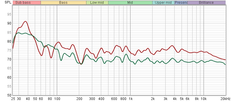

Well I too have been using REW in the past few weeks to get familiar with my room and start the treatment process. This is where I'm at so far with just (4) 2X4 by 2 inch thick panels of 703 on back wall. My goal is to get Dirac out of the process after all is done. just these 4 panels at back wall took a lot of mid band energy out of the response. Must say, as you can tell from the corrected curve for MY room, it is a HUGE sonic improvement.
This has noting to do with the M3's being this way, or that way regarding fidelity. This is, as you know the sonic signature of my listening space.
Jon L

I use some 2'x4'x2" and 4" panels.  Even after the 2x4x2 panels, your room looks to have at least 15dB peak in sub bass compared to midrange.  Are you planning to introduce some bass traps or EQ cut?

I have the sub turned up to much. I forget to post, this is with a sub. I am actually gathering materials now for front corner floor to ceiling traps, going with diffusion on the front wall. Lots to still do yet. Definitely a labor of love.

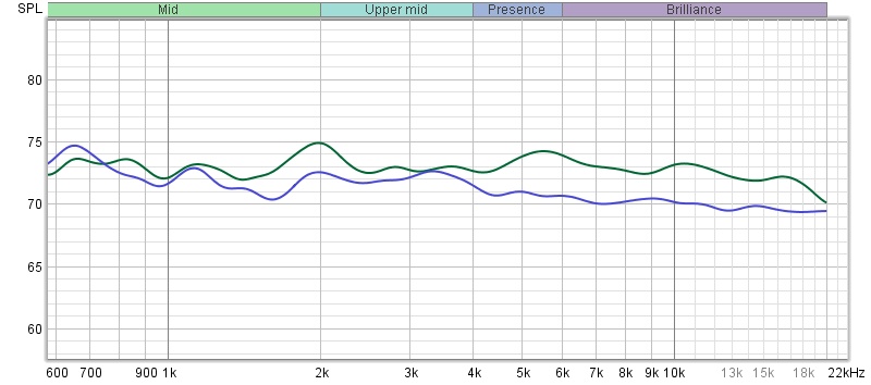

For those that think things are a bit bright, again this is what my space is doing to the "entire system" this has nothing to do with the speaker itself. Just want to make that totally clear. You can clearly see the reduction in the high's. I only have 5 feet behind my MLP and rear wall unfortunately. This has literally brought down the "perceived" level of the tweeters in a good way. I truly believe the best time and money one can spend is on acoustics, after all our systems are playing our rooms...
