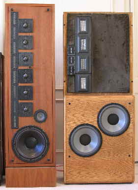

In 1976 Infinity released a new type of speaker called the Quantum Line Source, or QLS
Quasi line source by Paul McGowan - August 24, 2018
https://www.psaudio.com/pauls-posts/quasi-line-source/
The QLS and 4.5 next to one another

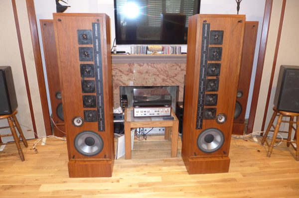

Infinity RS-1 - "As you can see by this picture everything about the speaker cries “line source” except the tweeters."

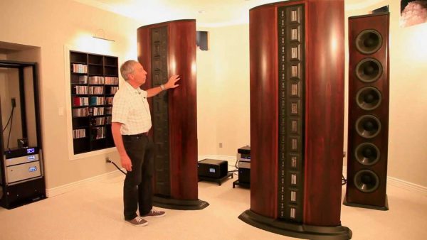

Infinity IRS

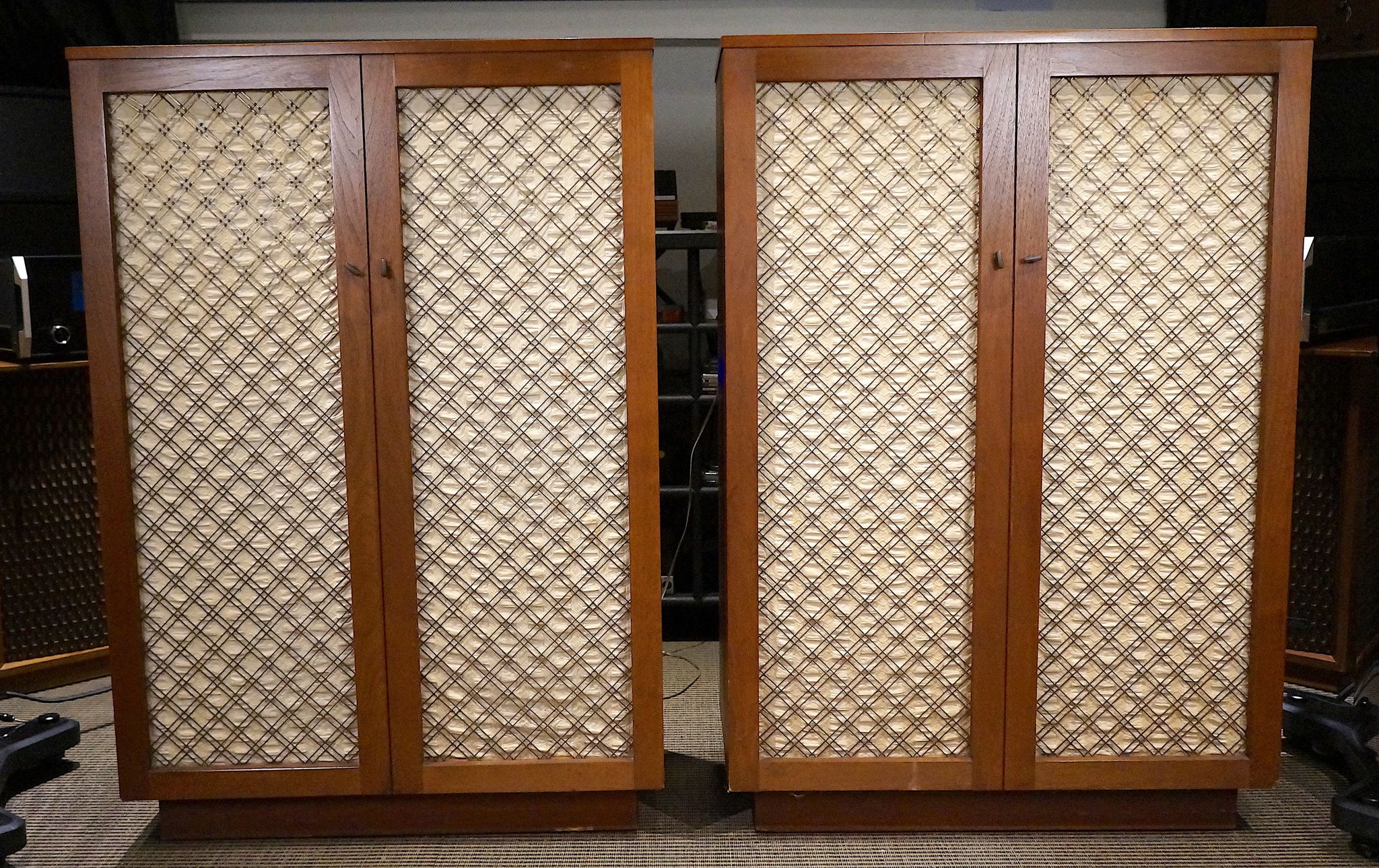

October 2007 - Danny is shown standing next to the GR Research LS6. Priced at $4500/pair, the speakers feature eight 6.5” woofers and six planar magnetic drivers. The LS6 not only boasts a 20Hz–20kHz frequency response, but also features bass drivers that are adjustable according to what the room and system can handle. https://www.stereophile.com/rmaf2007/101407gr/index.html
The Bozak Concert Grand B-410 loudspeaker from the early 1960's is one of the first commercial speaker designs that used a line array. As big as two refrigerators, weighing 225 lbs., each speaker had eight 2" B-200Y Dual Treble aluminum-diaphragm tweeters, two 5¼" B-209B aluminum-cone midrange units, four 12" B-199A variable-density (pulp made from lambs’ wool and shredded paper) cone woofers in a sealed cabinet for a 28Hz low range.
Stereophile has a 2005 review: https://www.stereophile.com/historical/1005bozak/index.html
There is currently a pair of  Bozak Concert Grand B-410 loudspeakers available in Chicago for $2000.
https://www.audiogon.com/listings/lisabdfj-bozak-audio-lab-concert-grand-b-410-full-range?
The inside of the speakers - photo from another site, not these speakers
