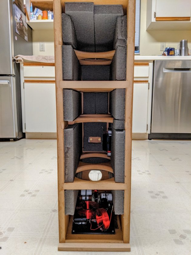

Here's a picture of how/where installed the NoRez into my cabinets
Just be sure to leave an inch or so between the Norez and the front baffle

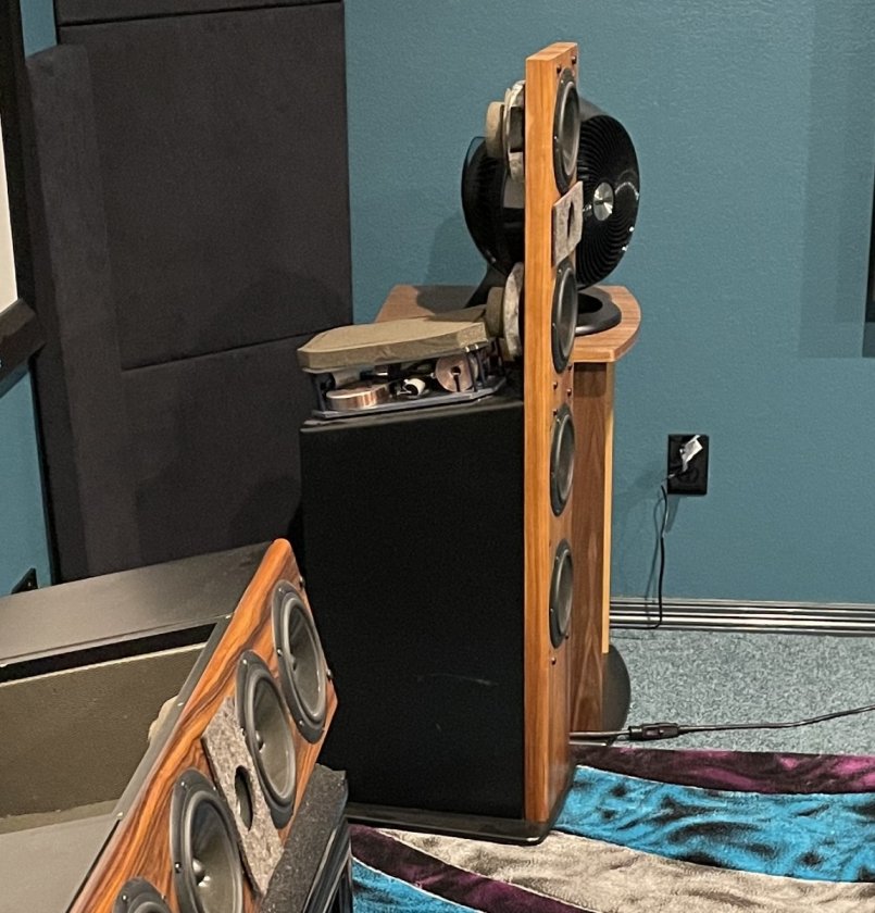

And here's mine, fitted through the driver openings and bottom plate. Mine are the original AV123 X-Statik's, though I call them GR Research instead.

Fantastic!  Thanks Hobbs.  Thanks Chops.
Those photos are incredibly helpful.  I like how you split the cross-over Hobbs.  It’s a very tight fit in the base along with the thread insert blocks I’ve added to allow the base to be demounted.

Well, if space in the cabinet is an issue, you could always mount the crossovers externally.

Off the subject a bit....why the felt around the tweeter?
Vince first I have speaker envy and now like I said to Hobbs I have crossover envy. Nice looking setup. :)
How is the tweeter treatment working for your setup? What is it controlling?
Thanks
SC
I haven't personally dissected it (aside from fixing the base on one and attaching feet).   I was the lucky recipient of these through The Music Room.   They were originally owned by author and musician Steven Stone.   There's a long thread on here discussing the origin of that no-res on the back of the drivers.   He was also the pioneer of those screw caps.

Wow.  Great photos Vince - a photo really does tell a story.
I must admit, I like looking at my cross-overs, but am worried about kid's (and adult) sticky fingers - I'm working in the 'out of sight - out of mind' school of thought. I will be fitting speaker grills for exactly the same reason.
Thanks
SC
Those speakers are as old as mine, both being original AV123. Those particular speakers' crossovers were upgraded by a company called Skiing Ninja. https://audiophilereview.com/affordable-speakers/a-springtime-switcheroo-and-an-x-static-value/
As for the felt around the tweeters, I suppose it's to help minimize or possibly eliminate diffraction. I tried the same felt on mine as well as open-cell foam and closed cell foam, and I didn't care for the sound of any of them. Of course, that's my opinion/taste.

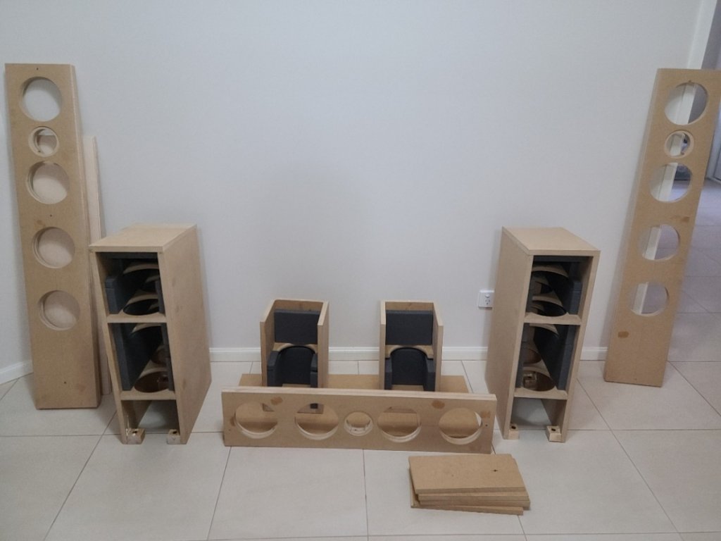

I've now finished the internal no-rez installation on the X-statik and X-voce.  I've got to say its incredible stuff.  The difference I hear from my routine cabinet knuckle-rap is remarkable.
I found it very easy to use and easy to cut.   Only downside I have seen, is its a static magnet.  I do all my cutting on a foam sheet to protect worktops etc - the no-rez just 'sucked up' all the loose particles of foam and keeps any sanding dust stuck to the sides of the cabinets.  A good internal vacuum and tacky cloth wipe-down solved all those issues though.
Some 'work in progress' photos.
A great product - thanks Danny.
