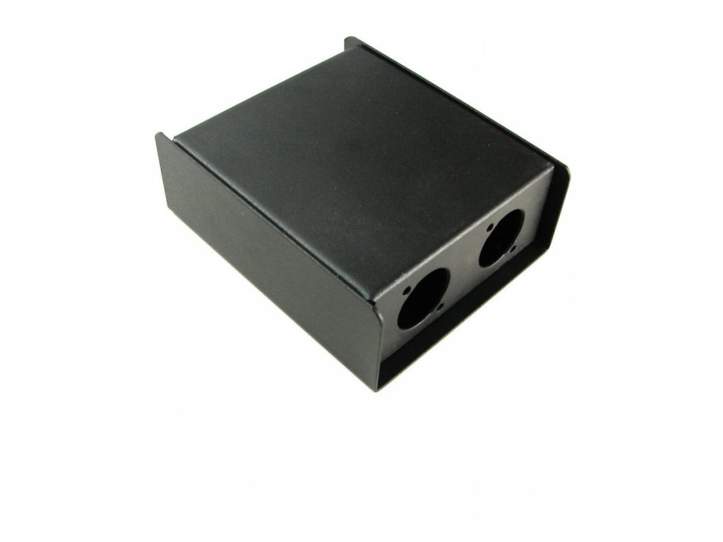

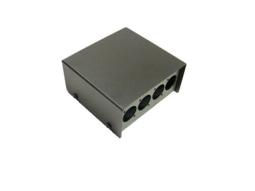

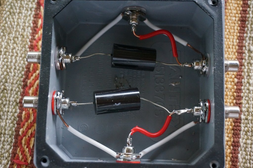

You can make them a number of ways. I've used PVC electrical boxes that I got at the big box stores and metal boxes from eBay. I've used Cardas connectors I got from SonicCraft
electrical box.
https://www.lowes.com/pd/CARLON-Gray-Weatherproof-Pvc-Junction-Box/1000975650
Metal box
https://www.ebay.com/itm/Steel-Project-Box-4-1-2-x-4-3-4-x-2-3-8-Pre-Punched-for-6-D-Series-XLRs/261808804730?hash=item3cf505537a:g:liwAAOSwfcVUEdB8
