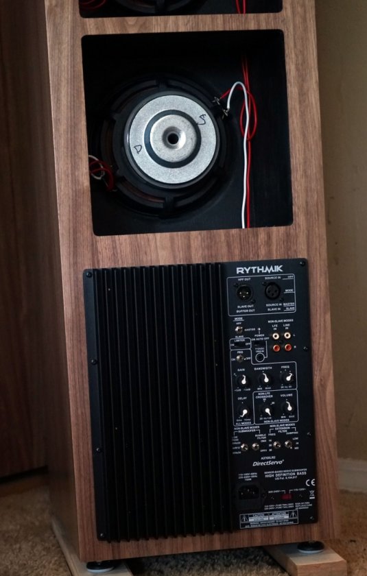

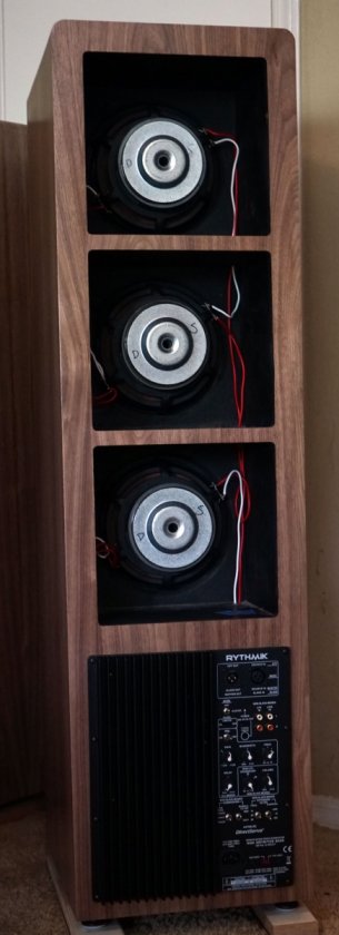

I've built two pair of triple towers with the amp built in an additional chamber under the drivers sized to fit the amp. I didn't use any sand and there are no problems with stability
subsonic1050
Re: Dual sub H frame with built in amp
« Reply #3 on: 16 Oct 2021, 07:11 pm »
I did a built in amp base and I did fill it with kitty litter. You can see my build here:
