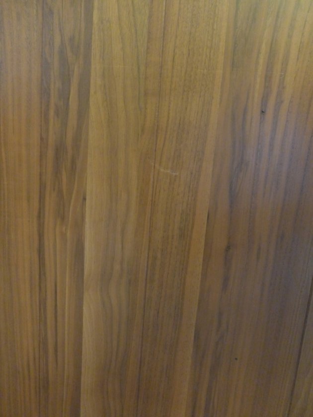

Do any of you wood experts know what wood my console is made of for sure?

It looks like oak to me but I wouldn't swear to it.

Looks like Walnut...a little faded. It was popular and plentiful in the era.
You could stand the cabinet up if you have the vertical space. Horizontal MTM is not ideal, it's just what folks want or expect to see.  I don't know if Danny tilts the response on these for center channel use.
Walnut seems right.

It looks like butternut, but could easily be a lighter walnut. If you can easily dent it with a fingernail it's butternut, if you can't it's walnut.

My guess is walnut as well. If not stained walnut will fade over the years.n And it was very popular to use on stereo equipment of that time.
To hard for the fingernail.
Definitely walnut then. Just faded over the years a little.
