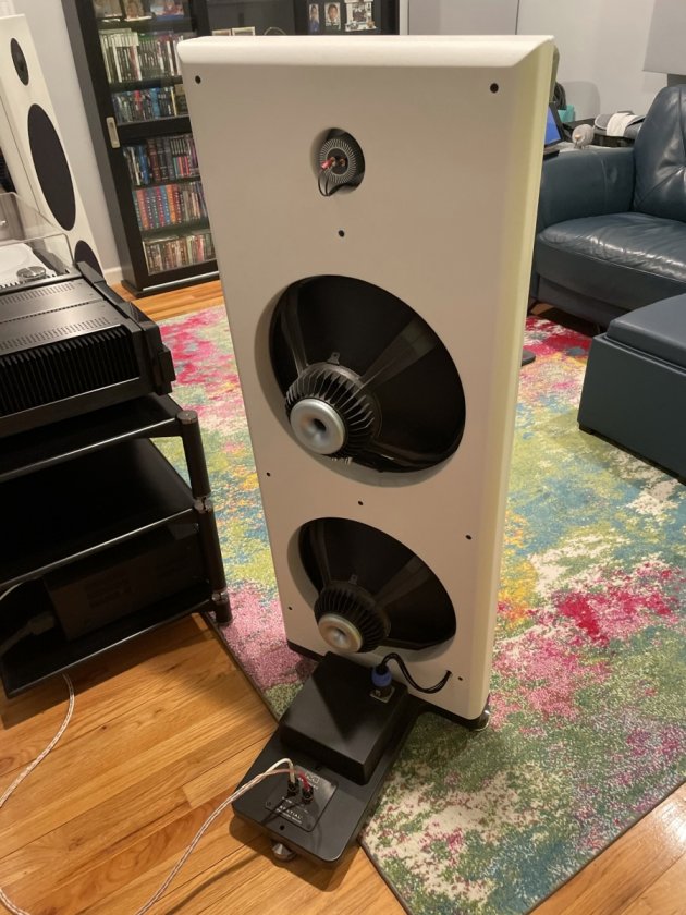

I know there is a thread for aftermarket feet for the X series w/ some posts from M users but wanted to start a specific thread.
Can any GAIA owners (my IIs arrived yesterday) chime in on the hardware they used and if straight bolt (screw) in? ....and any other helpful info.
The guy I bought mine from was kind enough to make this video for me but I really don't want to drill into my M3 bases. https://www.youtube.com/watch?v=XwdR_UjPFQE  , which is why I'm asking for help here.
Thank you.

I have the newer style M3 Sapphires with the outboard crossover.  I was able to install them with the bolts that came with the GAIA II with no modifications.  You have to take the base off of the panel to remove the spikes.  That was all, no modifications need.
loki7177
  • Posts: 35
Re: GAIA on M3s Install ?s
« Reply #9 on: 8 Sep 2021, 02:11 pm »
You should be able to see them from these pictures.  Direct replacement for factory spikes.  No need for modifications.

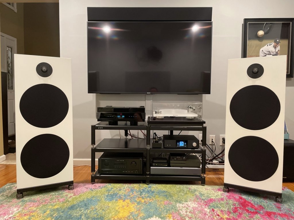

I should be receiving my hardware later this week. One thing I will have to take a look at is keeping the correct tilt. Hopefully the hardware supplied is able to accomplish.
Tangram
  • Posts: 184
« Reply #14 on: 29 Sep 2021, 03:42 pm »
Please let us know the difference in sound once installed. I am especially interested because I see your M3s are partly sitting on carpet.
I am surprised that people get such positive results with the GAIAs and Spatials. But given that Clayton is including them in some speakers as OEM tells me you guys are onto something. The physics don't make much sense to me, given the inherent design of the speakers, with no top brace to reduce movement of the baffle.
As for me, I (currently) am happy with the sound of my M3s. I also think the GAIAs detract from their elegant look. Not that looks should stop anyone from chasing the audio dragon, but the M3s are a particularly good-looking speaker as is.
forky
« Reply #15 on: 29 Sep 2021, 04:05 pm »
ok will do. mine are fully on carpet though - although - and I'm still working on this, one foot is on a rug (w/ the other 2 on carpet).
Agree w/ the looks but I'm function over form (unless maybe it looks like total crap) - will know more on that soon.
