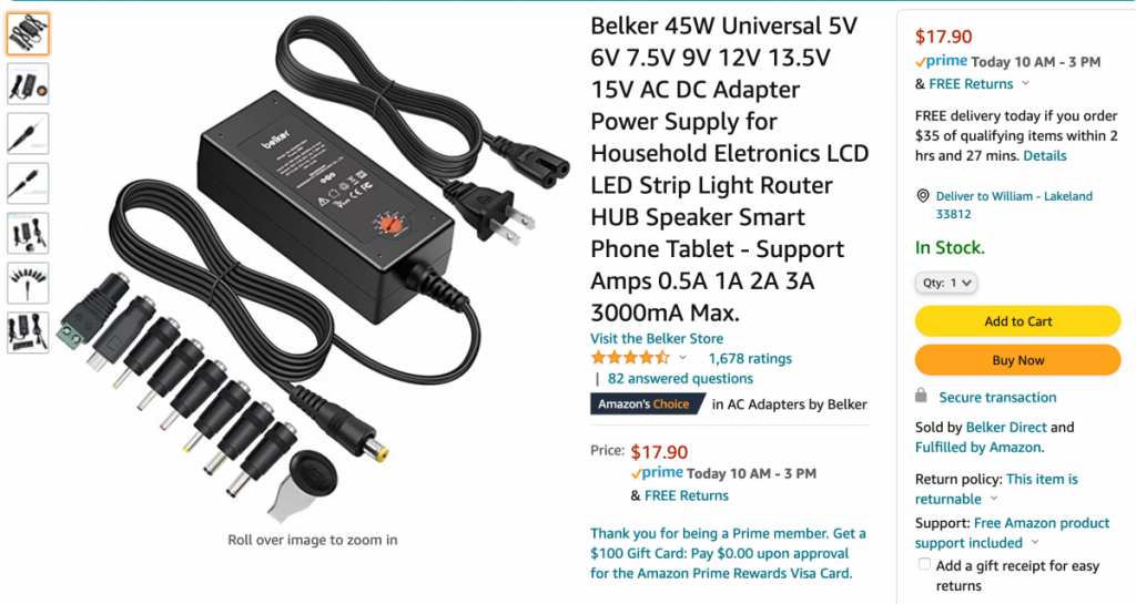

To aid cooling my Decware tube amp that's inside a well vented A/V console I installed a computer cooling fan powered by this inexpensive power supply. You can select the appropriate voltage that gives the right compromise between fan noise and cooling.
