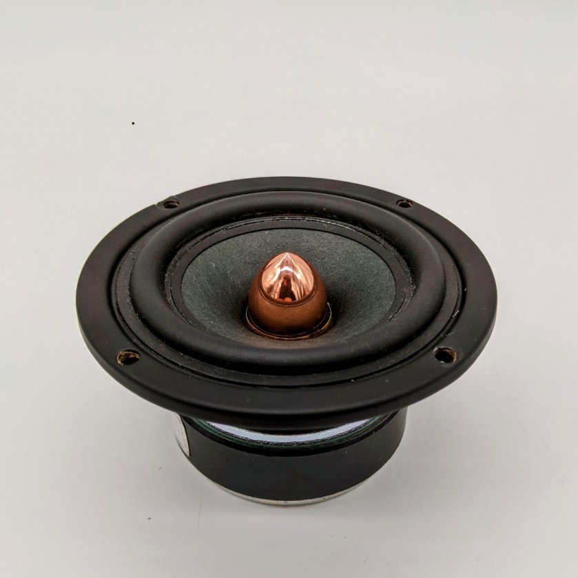

What are the differences between LGK 1.0 and LGK 2.0?

For those who are not familiar with the LGK 1.0. Here is a link to a nice review Ron at New Record Day did some time ago.
https://youtu.be/Efku5oMo0nY
The LGK 1.0 is gone and not to be replicated. Instead, years ago, Danny decided to Replace the LGK 1.0 with the LGK 2.0. Danny set new performance parameters and  specifications. The supplier (Peerless of India) of the single driver speaker has had difficulty meetings those requirements and further had production issues to return the finished product to GR Research. The rumor is that a limited number of the drivers were delivered and that there are proto-type "LGK 2.0" Units in the hands of a few persons. We believe that the box plans for the LGK 1.0 are not the best match for this driver. We do not know what design will be recommended. The speaker is ideal for near-field listening. These would compete with the desktop minis, in theory. That's about all I have read about it thus far.

They will need smaller cabinets than the original LGK1.0 did, but they also have a much better response, especially on the top, end where the originals were a little choppy.
The trick will be getting the volume and port tuned just right.
I created a design that looked like jet engine and it measured quite well, but it needs some design changes, but it also took forever to 3D print.. so I'm going to look into something a simpler to design/print. lol
Plus they look like miniature NQ woofers with a tiny copper phase plug.

Couldn’t the current cabinets be made shorter to get the proper internal volume? Or if you want to keep the height for tweeter position, add a solid brace to reduce the internal volume?
I'm sure there are things that could be done to adjust the original cabinets volume as they only require 0.11 cubic feet of airspace, but they also need smaller ports that are 1" diameter and 3" deep.

That is so small you may have a tough time getting your crossover parts in alongside the port. The crossover has maybe two, or three parts tops, I would think. .11 Cubic feet of space? It will be the size of the old Bose Accoustimass pods?  I wonder if the port has to be rear firing? Perhaps a down firing port might be interesting?

I am confident that smarter minds than mine are working on this but, unless I am doing this wrong, that means about 4.5 X 4.5 x 10 inches, after calculating the space for bracing. And the old box was 4.5 X 7 X 12 inches. Since Horizontal off axis can be an issue it seems like a stand would be required for it on a desk top. If great depth is needed one would have to reduce the height. So maybe 4.5 X 6.5 X 7 inches?

Internal volume is 4x6.25x7.5 with 1/2 inch MDF for the walls.
And we do intend on including a stand built into the cabinet that will raise it up by another 5 inches or so.
We plan to have the port down firing within the stand section
