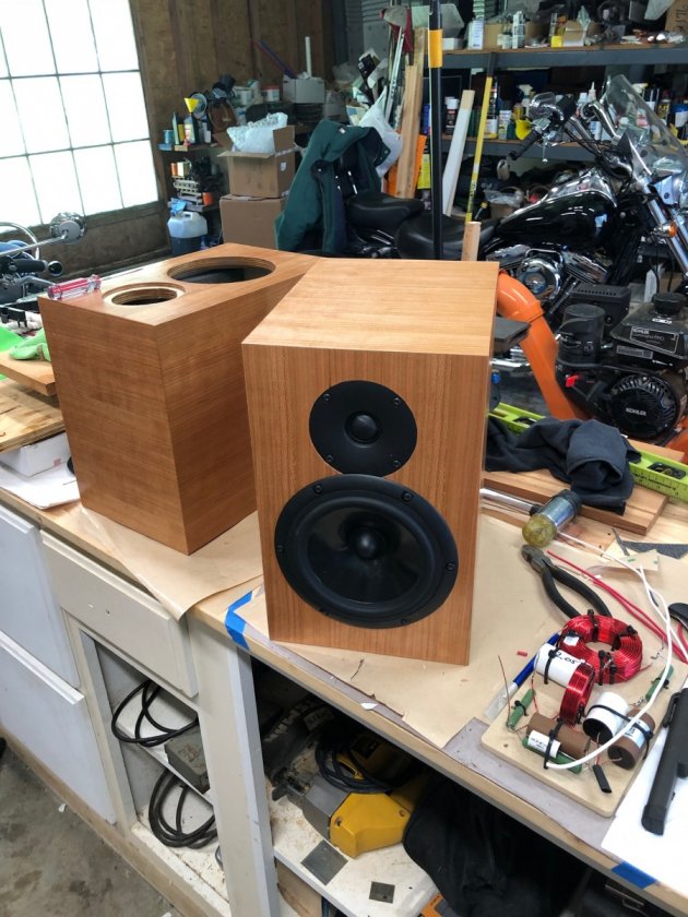

These are quarter sawn Cherry veneer over Baltic birch cabinets from Peter J.
They sound really good.

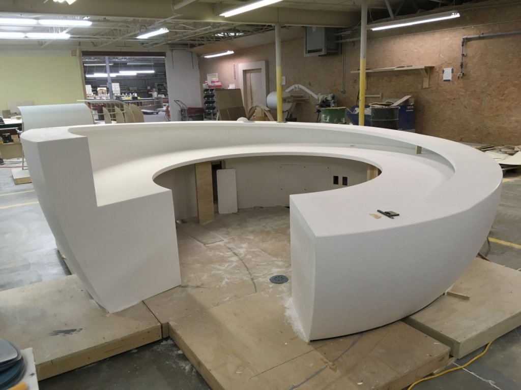

I've always thought that making a cabinet out of Solid Surface would be quite interesting. Or Corian, to the common folk... Tissue, Kleenex, you get the point. Definitely stays along the lines of me - quite dense :)
I've designed some fairly elaborate fixtures/displays using it before. Curious how it would sound. Certainly wouldn't be too hard to make a cab out of it.
Here's an example of what can be done with it (not my work):
Let me save you the time. It does not work well.
