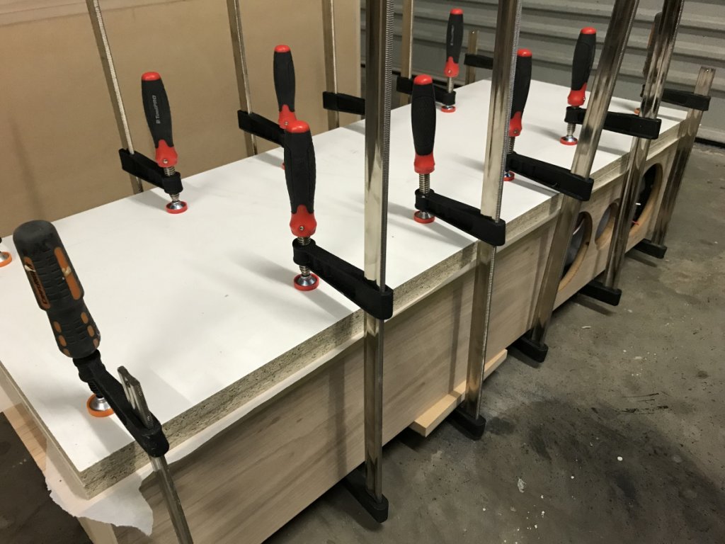

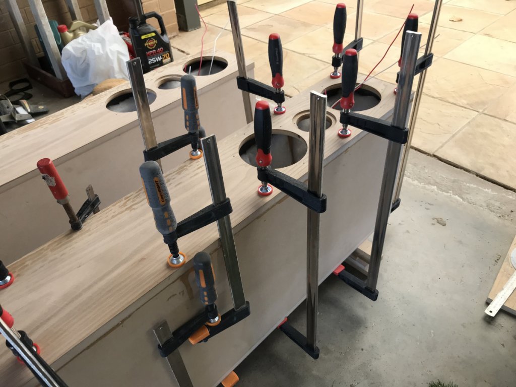

I’ve glued the front baffles on and have clamped down the veneer on the first side.

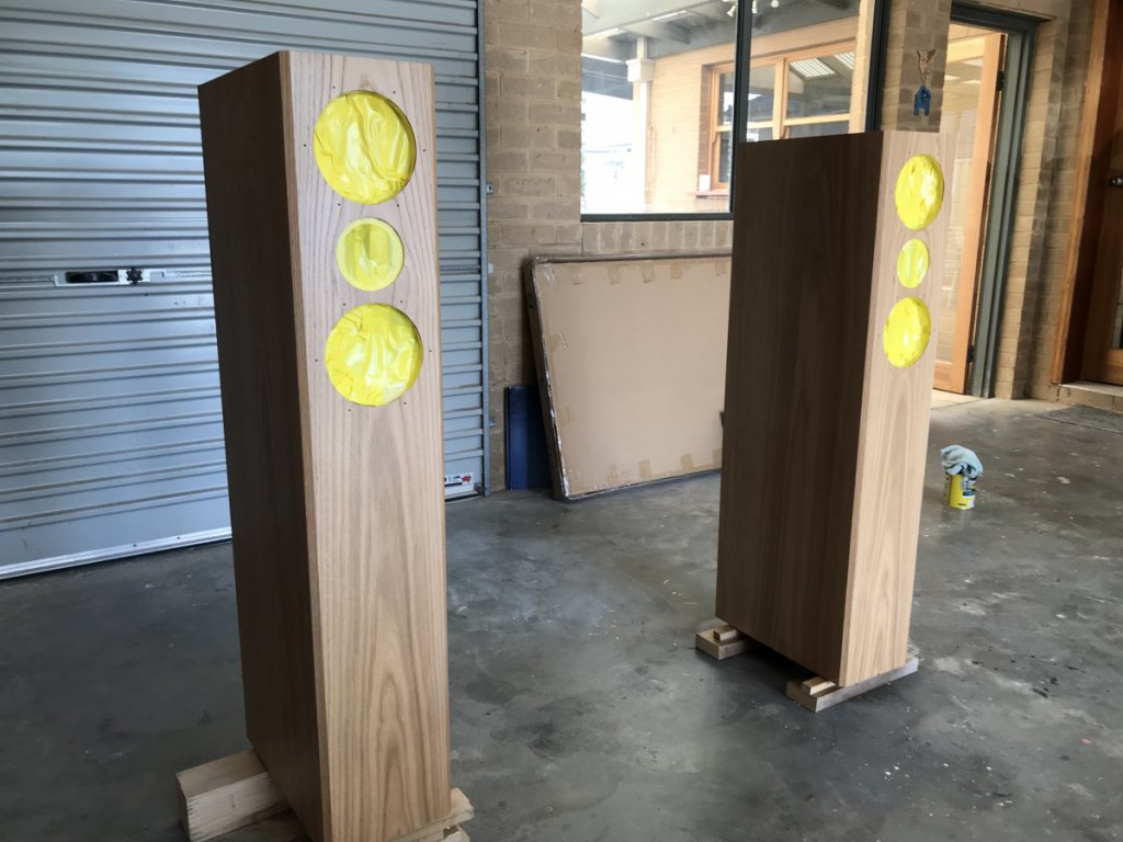

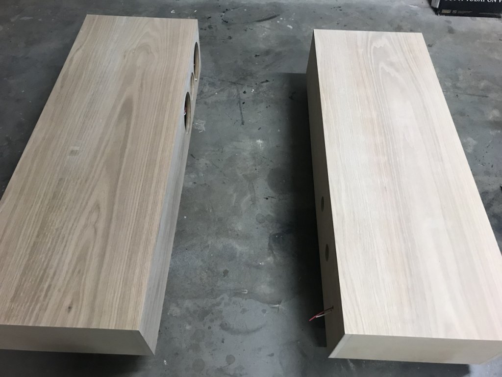

First side has veneer on it,
I can now get a look at what there going to look like.
I have had some glue bleed threw the veneer so I need to make sure all the glue is sanded off before I varnish the cabinets otherwise it will stand out.

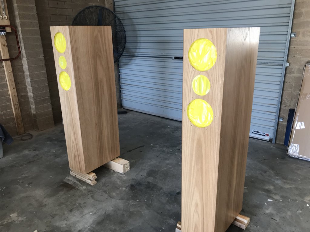

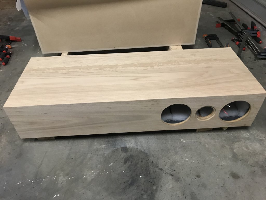

The right one has had some sanding done that’s why it looks lighter, but very happy with the Oak veneer grain.

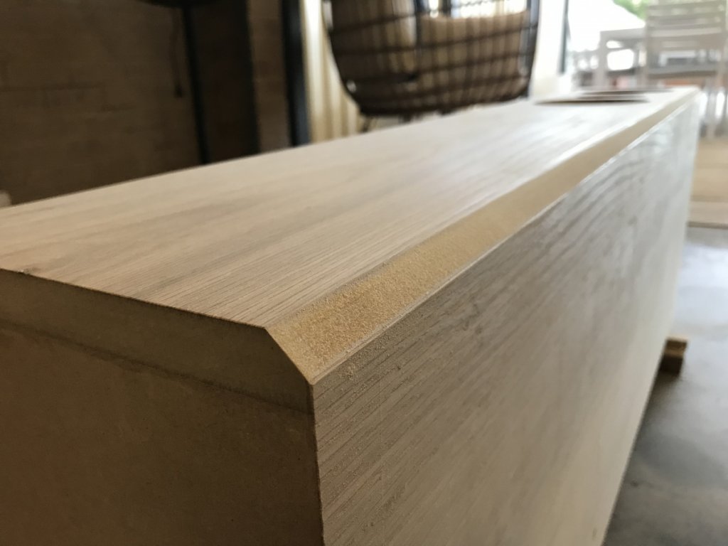

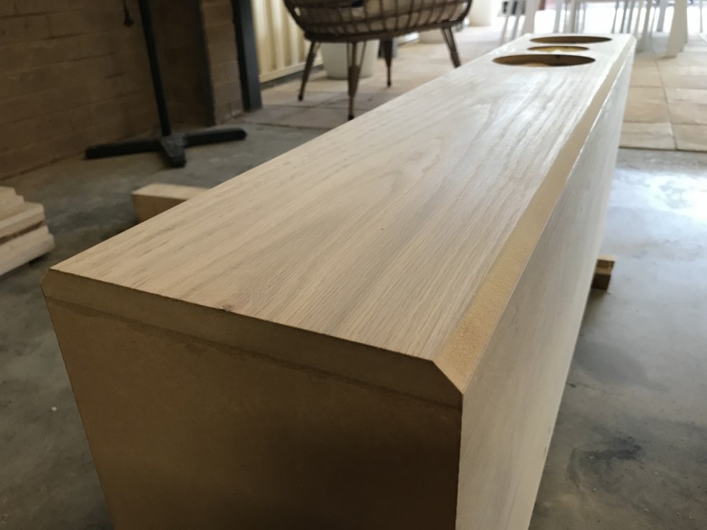

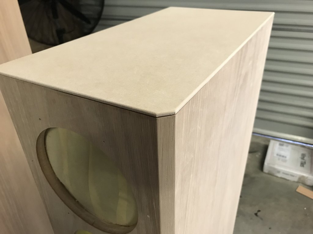

I’ve cut a 1/2 chamfer on the front edges to help with diffraction.

It’s easier to veneer a flat edge opposed to a rounded edge as well.

I know it has been a few days since you last posted... But did you chamfer the top corner too?  Sorry if it is in the picture; I couldn’t tell.  It would be good if it is, same as it is for the sides.

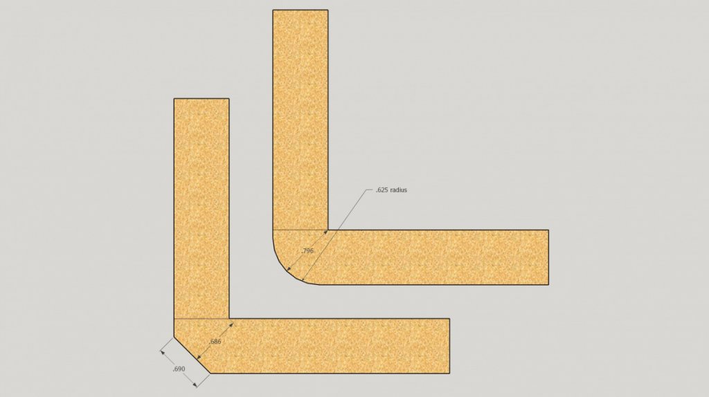

Since you are removing some wood with the chamfer doesn't that compromise the strength of the corner?
Or are you compensating by adding a corner block on the inside?
Peter J
  • Posts: 1966
  • Hmmmm
Re: X MTM Encore build
« Reply #73 on: 6 Mar 2022, 05:34 pm »
I'm not the builder, Oskar, but I can tell you that strength of the corner is dictated by the material itself in this case. The glue joint, the strongest part of a butt joint, remains fully intact from what I see. I'd have no concerns doing what's illustrated if the joint itself was sound. If the structure didn't have bracing elsewhere, and you were to do apply diagonal pressure corner to corner, I can see the strength being compromised by the reduced thickness at the corner, but this is a speaker box after all and there are shelf braces resisting that sheer force. One could add corner blocks but considering all else it would seem superfluous.
The notion that this would affect the performance of the speaker somehow just doesn't hold water, IMHO. Here's a cross-section graphic to help illustrate my point.
EDIT: I realized my illustration was wrong. I corrected it to show approximately 5/8" across the face of chamfer and 5/8 radius. Mo betta now.
« Last Edit: 7 Mar 2022, 02:44 pm by Peter J »

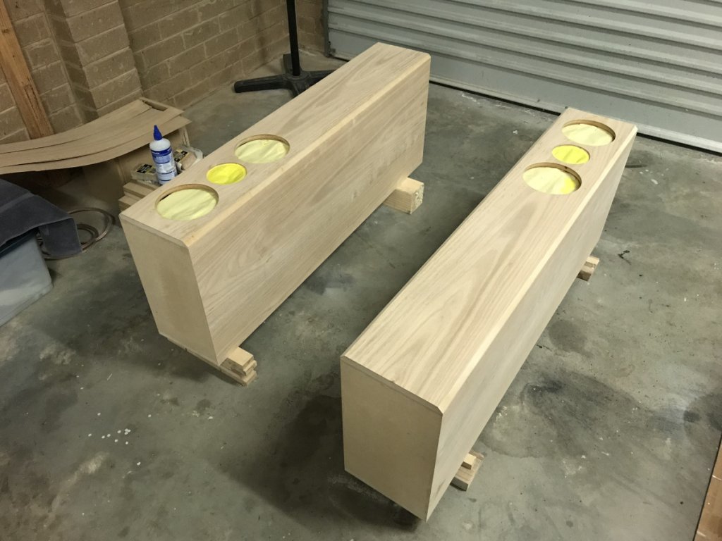

I have the sides and tops and bottoms glued on now, here they are standing next to one of my TriTrix speakers.

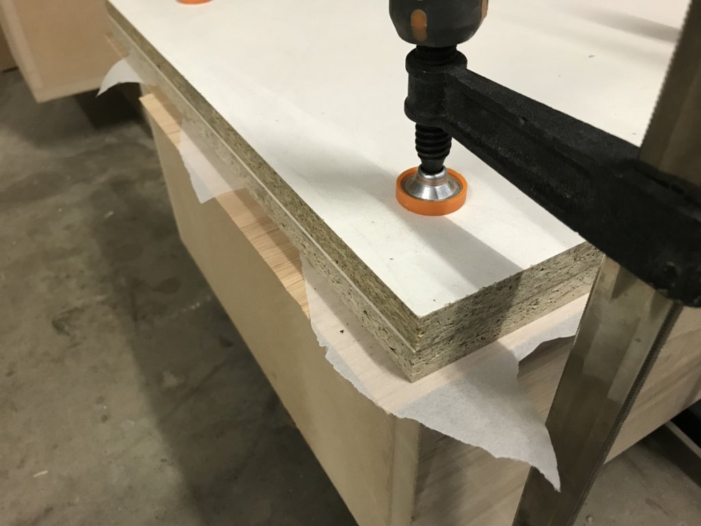

I’ve decided to make up 1/8 MDF panels and paint them black to cover the tops of the cabinets, and doing something similar on the bottom to keep some consistency.
