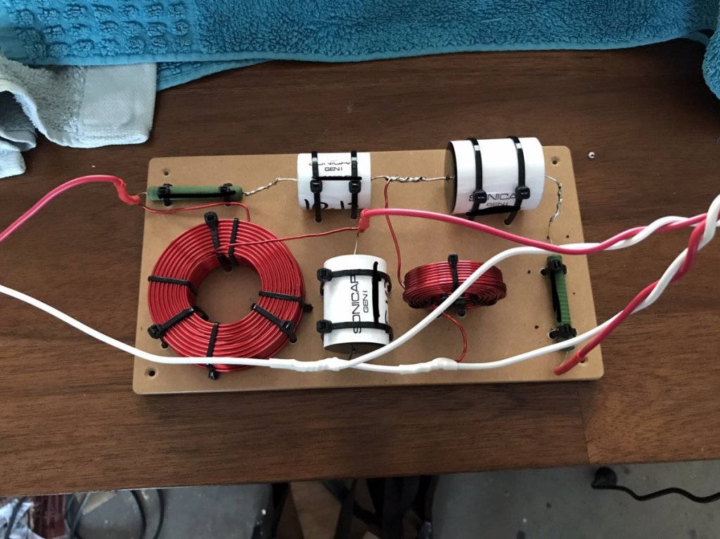

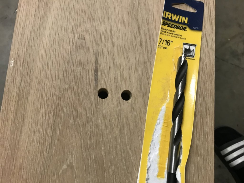

Hi all it’s been a while since I’ve posted any updates, but I’ve received the kit parts now
so I should have a good run from now on.
Here’s a few pix of my latest progress, I’ve drilled the 7/16 holes for the tube connectors and started laying out the parts on the board for the crossover.

  • Posts: 2741
Re: X MTM Encore build
« Reply #41 on: 12 Jan 2022, 04:09 am »
Looking good!
(Remember to hide the parts values of the crossovers before posting, thanks!)

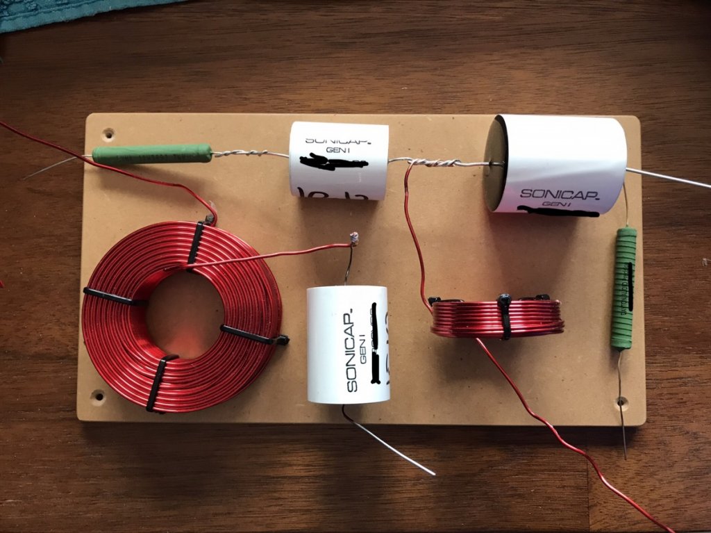

« Reply #42 on: 13 Jan 2022, 08:40 am »
One crossover completed
« Last Edit: 13 Jan 2022, 11:16 am by Coreyportelli »
Hobbsmeerkat
  • Posts: 2741
« Reply #43 on: 13 Jan 2022, 03:01 pm »
Very clean! :thumb:
« Reply #44 on: 15 Jan 2022, 08:55 am »
Second crossover completed
« Last Edit: 19 Jan 2022, 04:57 am by Coreyportelli »

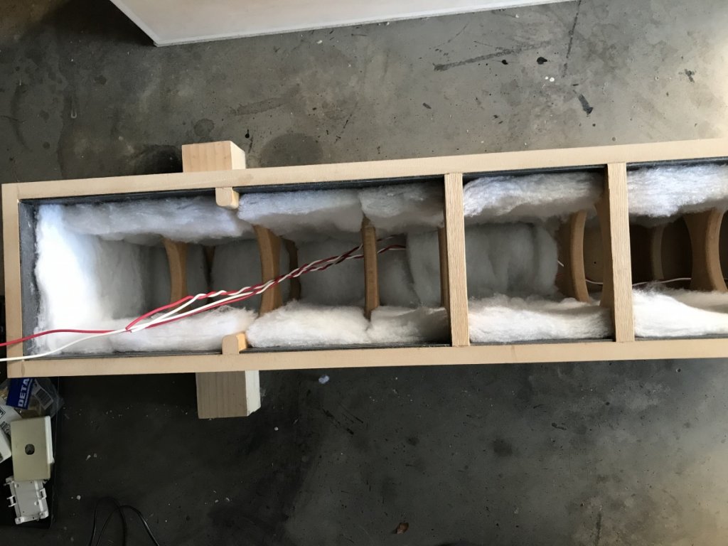

  • Posts: 69
« Reply #45 on: 17 Jan 2022, 11:01 am »
Crossovers and polyfill fitted to the cabinets, I used some spray on contact adhesive to help hold the polyfill to the sides

I have a question for anyone that has some knowledge on this kit.
The plans for this kit show the ports to be 3 1/2 inches long, but the ports supplied in the kit are over 4 1/2 inches long, I was wondering if I need to cut these down?
Hobbsmeerkat
  • Posts: 2741
« Reply #48 on: 18 Jan 2022, 06:36 pm »
Danny says it's not necessary to cut them.
The longer tubes allow them to play lower, and shortening them will reduce that extension a little bit.

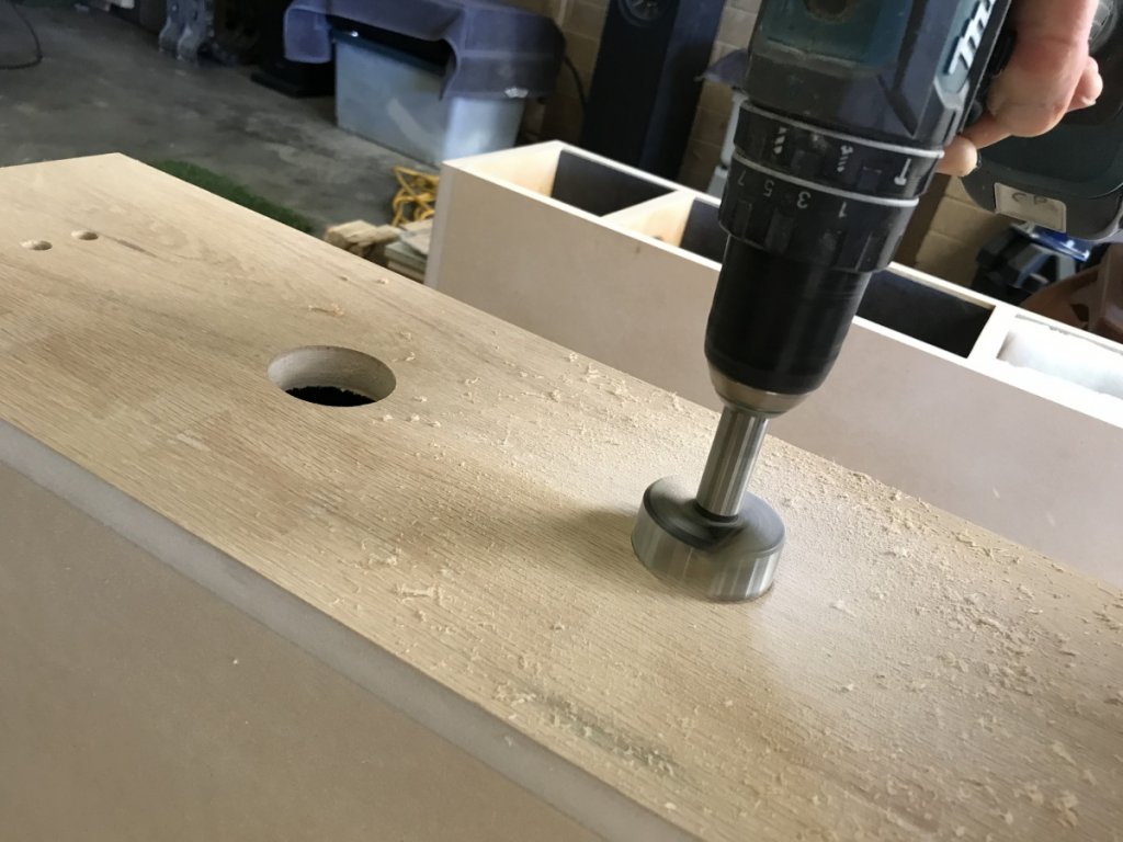

« Reply #53 on: 19 Jan 2022, 08:15 am »
I used a 50mm Forstner bit to drill out the port holes, the port tube fit perfectly

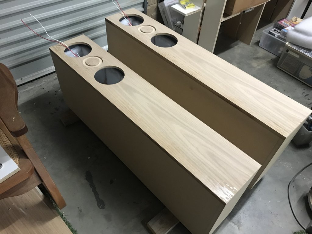

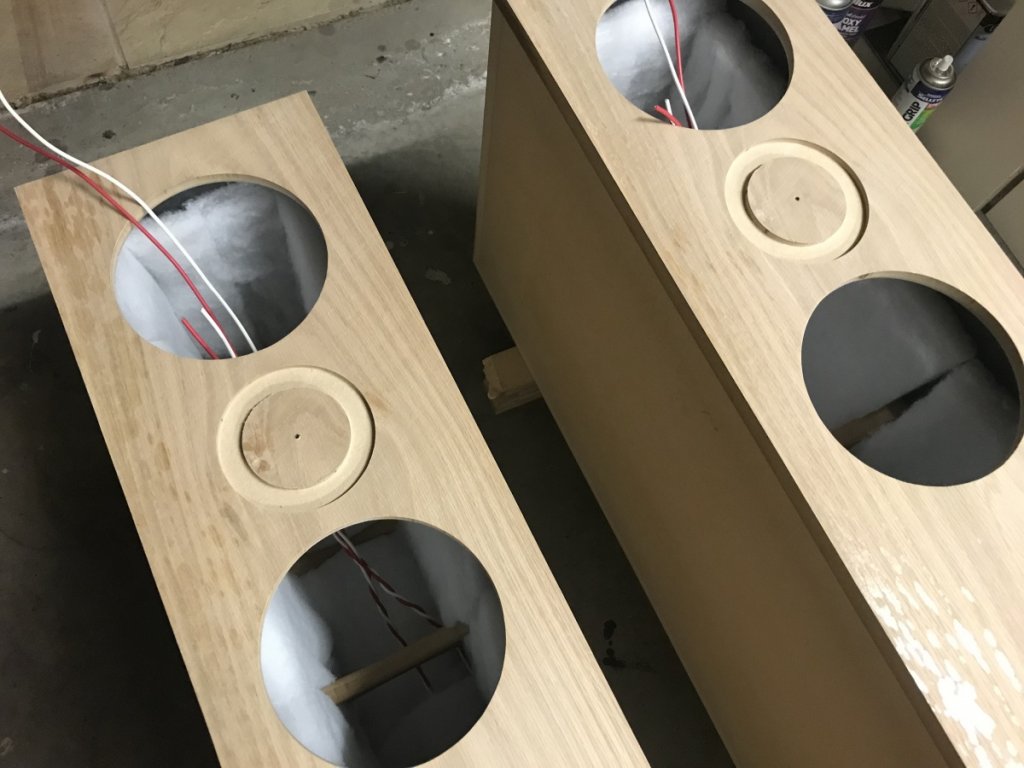

« Reply #55 on: 25 Jan 2022, 11:41 am »
First cut made for the tweeter after doing some test cuts to adjust the diameter and depth of the cut

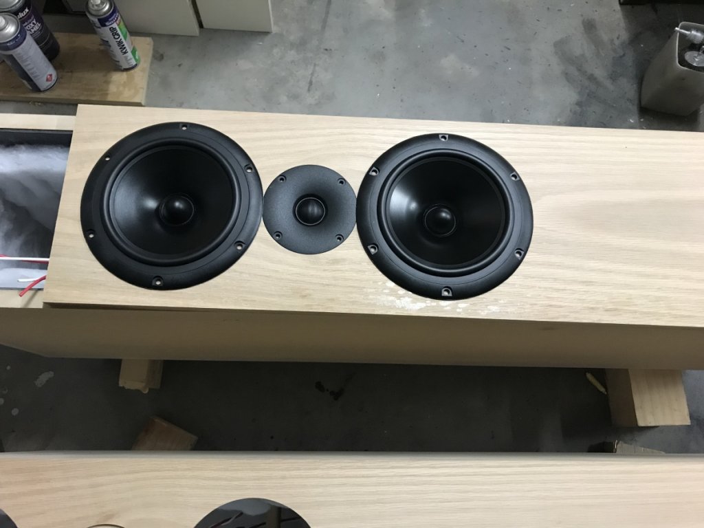

Coreyportelli
  • Posts: 69
« Reply #57 on: 26 Jan 2022, 11:10 am »
Thanks
Coreyportelli
  • Posts: 69

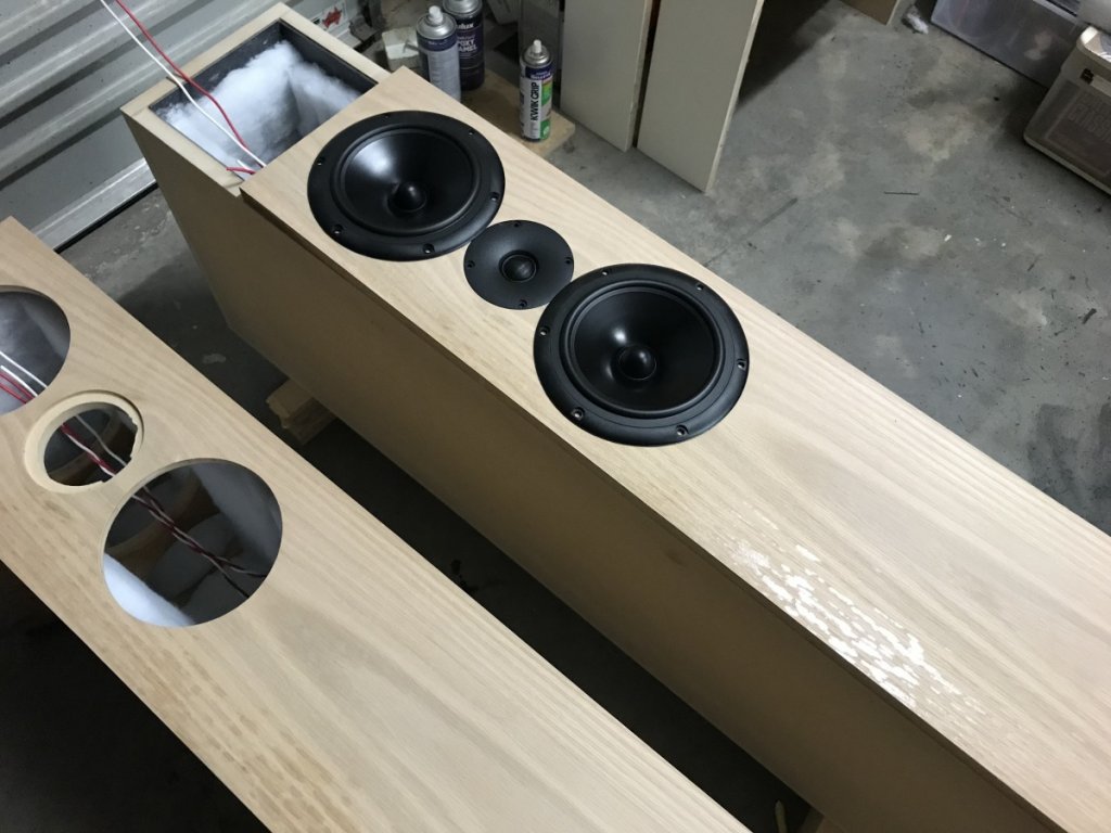

« Reply #58 on: 26 Jan 2022, 11:15 am »
Driver test fit into front baffle
« Last Edit: 28 Jan 2022, 09:48 pm by Coreyportelli »
Danny Richie
« Reply #59 on: 8 Feb 2022, 01:41 am »
Looks nice. If you can, round off the corners.
