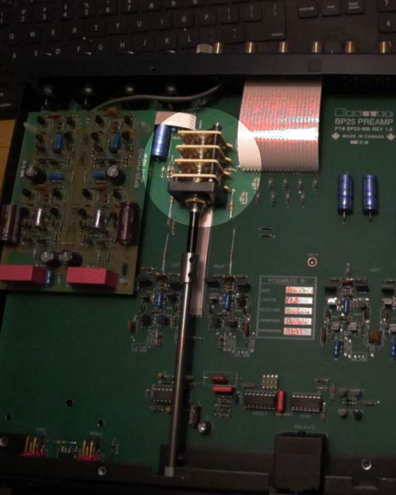

rob80b
Re: Can current BP-26 still work wth MPS2 Power supply?
« Reply #7 on: 8 Aug 2021, 04:07 pm »
I own a B-26 and a MPS2 power supply.
The BP-26 volume has an intermittent problem of losing the right channel. ,........
Hi Liz
Had a similar problem way back on my BP25...not saying you have the exact same issue but it was just oxidization on the the input switcher....
The volume pot is sealed but an easy fix for Bryston if sent in, plus they'll most likely do a full overhaul and return it as good as new.  :D
My system appreciation has been fairly consistent until just recently, balance starting swinging to the right, which I blamed on allergies, then I felt my vinyl sounded a bit distorted which I blamed on the cartridge/needle, then there was a bit of leakage and buzzing from the phono to the balance 1 input, also there was an increase in static when turning the input selector, at which point giving the input selector a couple of back and forth rotations hoping to self clean the contacts I lost volume on the left channel of the phono stage and then the other inputs. :bawl:
Well to make a long story short I did the normal trouble shooting and came to the conclusion the BP25P was the culprit :idea:, so before sending her off to Bryton I popped the lid.
The contacts for the input selectors are not completely sealed although there is a partial plastic covering, by saturating the corner of a very thin piece of paper with methyl hydrate I was able to clean the contact points and voila all of the above mentioned problems were eradicated  :banana piano: and the selector noise which was always there from day one was also cleared up, zero static, silent. Maybe even the erratic tick I hear from time to time when playing the BCD-1 was attributable to a dirty contact but only time will tell.
So with a little internal house everything sounds better than I ever remember. :beer:
