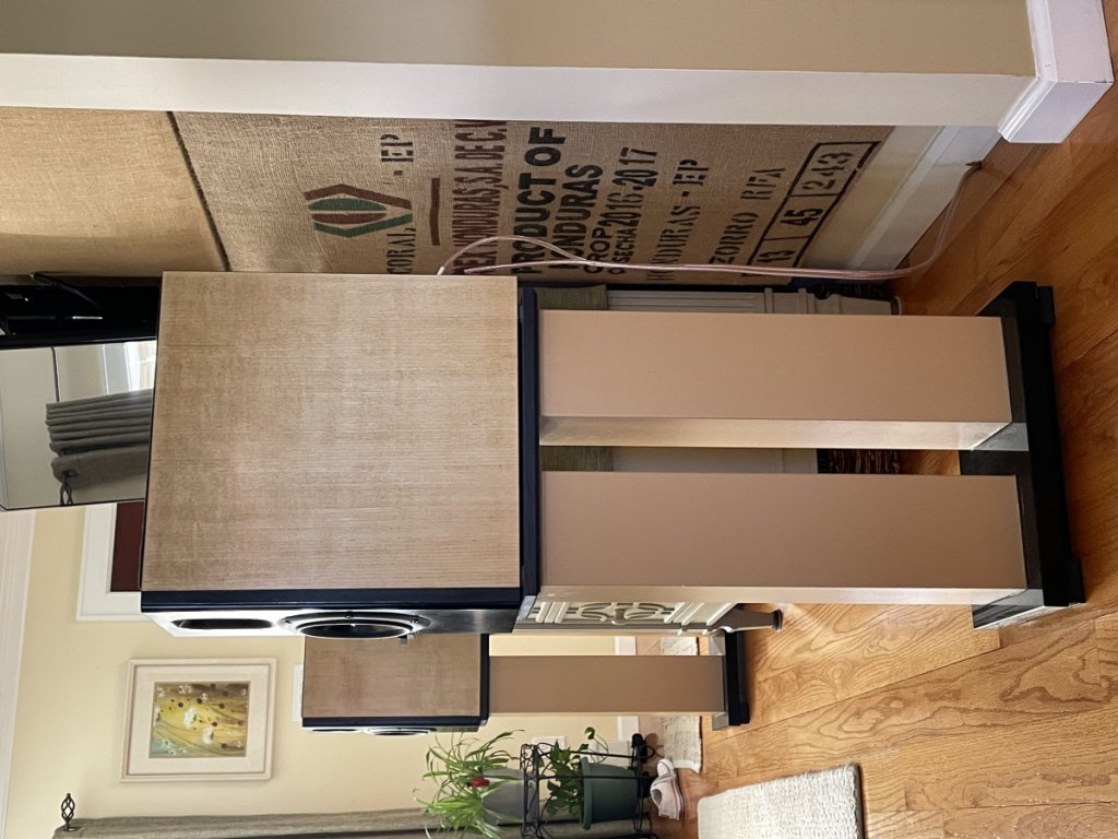

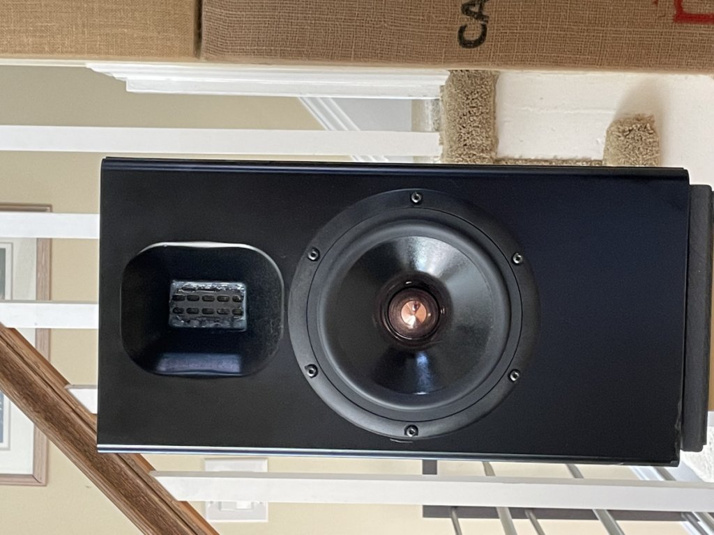

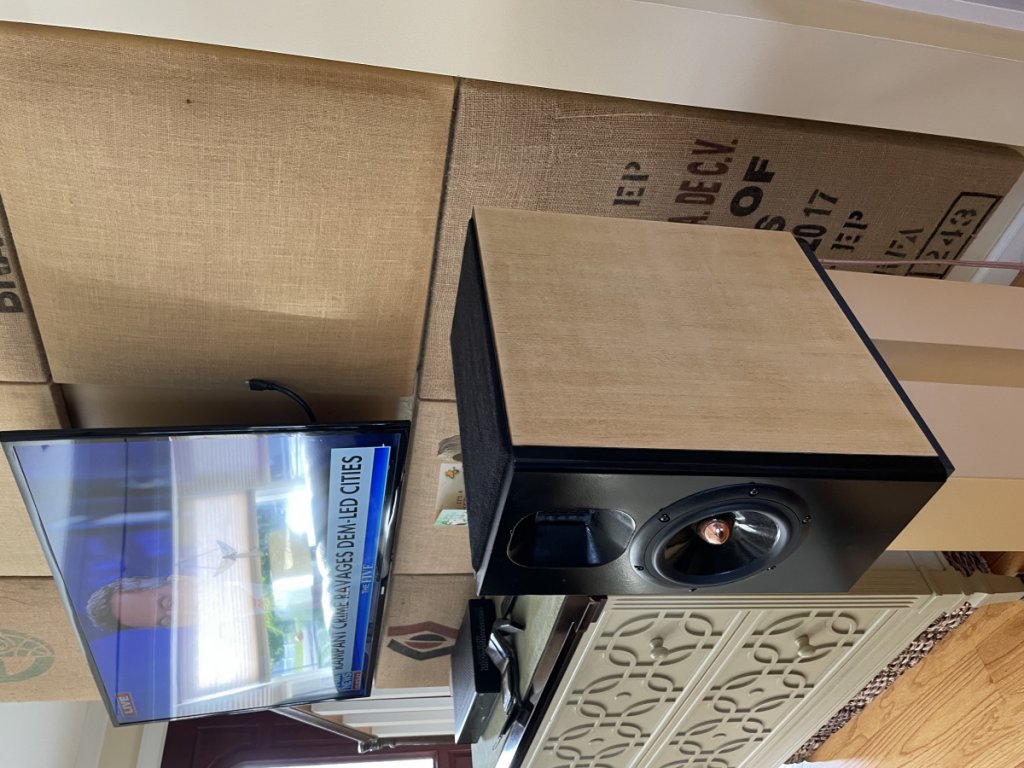

Hi everyone, so I finally got the NX studio monitors done a couple months ago. After a couple small problems, they are finally sounding spectacular! My original crossovers had path resistors that were brand new but bad. I had them redone with Mills resistors. Everything is now working correctly, and they sound wonderful.

Very nice Jmac. They look amazing!
