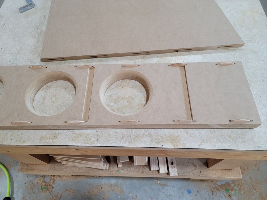

Hey everyone - I knocked out these XStatik cabinets for a friend yesterday. I'm about to do the roundovers on the backs of all the driver holes as well as the braces.
I have two questions - Are people generally gluing the cabinet up in 2 operations (the main cabinet first, then adding the front baffle) and installing the NoRez before the front baffle is glued on - or are people primarily gluing the whole thing up and installing NoRez through the driver holes?

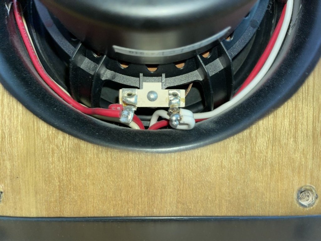

2nd - I've seen some XStatik's in which the wiring for the open baffle section is fairly hidden. How are people achieving this?

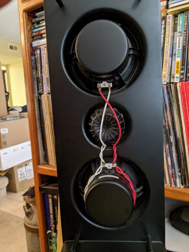

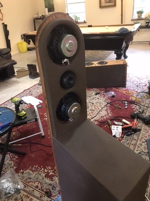

This is how AV123 wired them.
subsonic1050
Re: Subsonic's XStatik Build
« Reply #4 on: 23 Jul 2021, 07:25 pm »
That is extremely helpful corndog! I was thinking about drilling some kind of angled hole back from the lower woofer, which must be what they did. It's also helpful to see how they routed the rest of the wiring. Thank you!

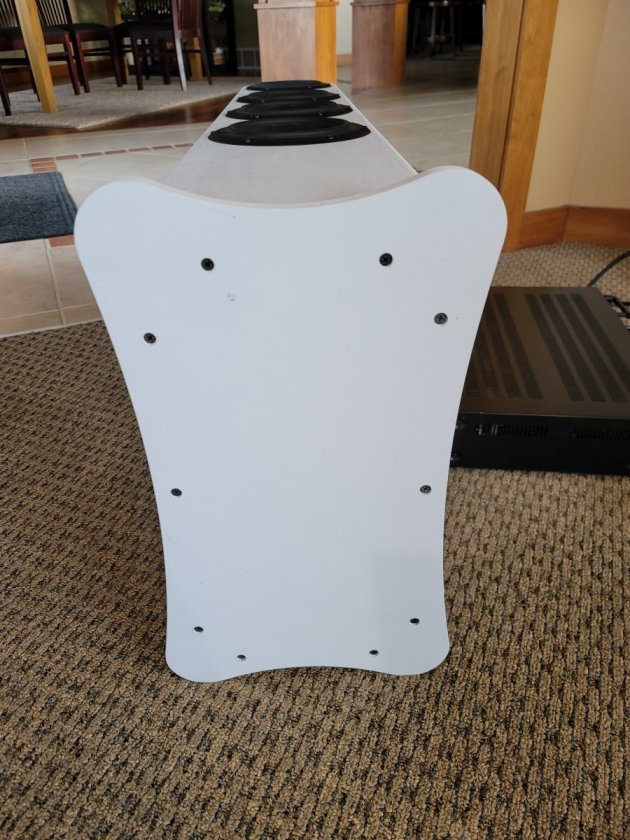

Theronbo
« Reply #6 on: 23 Jul 2021, 09:40 pm »
Put a back plate on the upper bit… sandwich the wires in between.
Theronbo
« Reply #7 on: 23 Jul 2021, 09:42 pm »
Bolted front plate on.
Put grooves in top of lower cabinet to feed wires into the sandwich.

My AV units were wired a little differently, but still had the wires coming out from the woofer hole. I did my best to match that with my replacement cabinet. The goal it for it to come out just above the woofer hole and just below the top of the cabinet. A little difficult, but not impossible.
subsonic1050
« Reply #10 on: 25 Jul 2021, 07:56 pm »
Thanks Hobbs - that is essentially what I ended up doing. I drilled holes in the baffle to route the wires between all of the drivers, not just the cabinet to the first woofer. We'll see how it goes!

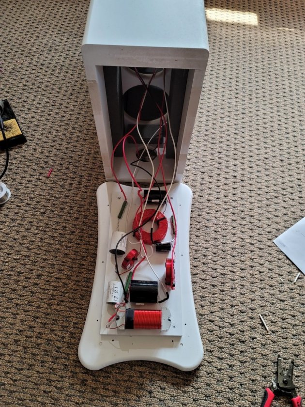

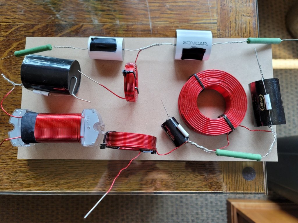

Next question - does the wiring for my crossovers look correct? How about the positioning on the board? I didn't solder anything yet, and I didn't fasten anything down yet either - wanted to make sure it's right first.
Hobbsmeerkat
  • Posts: 2741
« Reply #11 on: 25 Jul 2021, 08:41 pm »
The X-statik is a tough one, cuz there's 4 inductors in a relatively tight space.. i ended up separating them into 3 different boards and spacing them out, just to avoid any issues with the inductors.
I would turn the top inductor to it's outside faces the large inductor, then turn the massive bass inductor 90° so its leads are facing to the top, and turn the bottom mid inductor to face the large inductor on the right.
subsonic1050
« Reply #12 on: 26 Jul 2021, 01:14 am »
Thanks Hobbs - I like your suggestions about where to move the inductors. That is the difficulty here - finding a way to place them properly in a confined space!

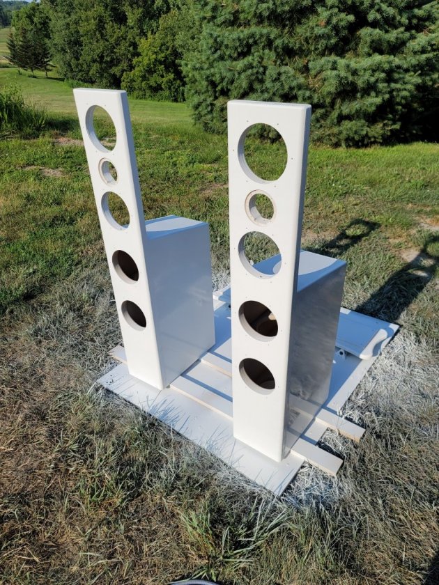

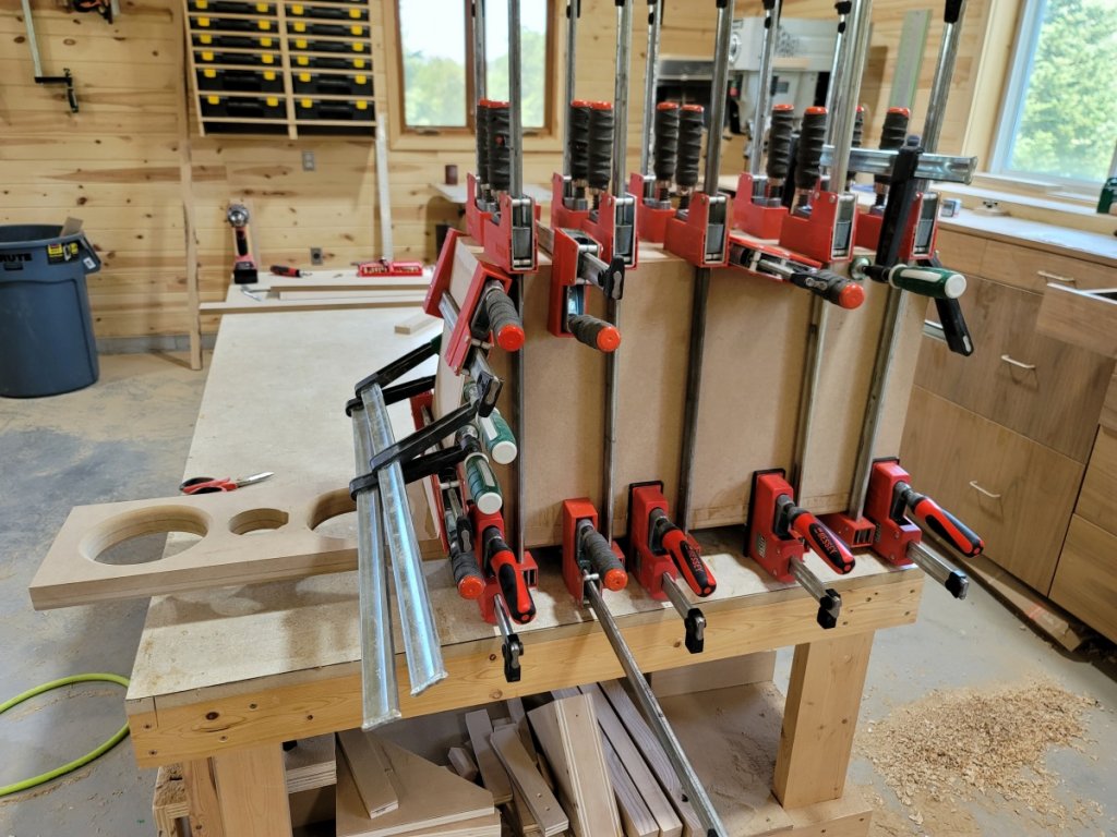

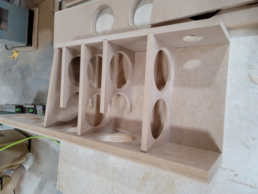

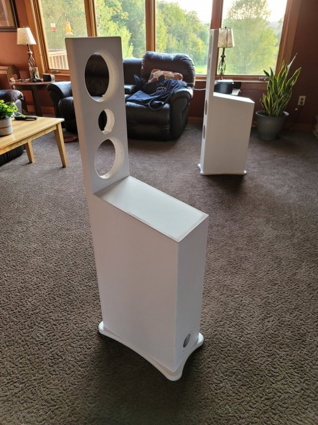

I got more work done on the X-Statik's. I decided to trust my woodworking gut and to glue up the cabinet all at once - I'm very glad I did it that way. I also decided to use some biscuits for alignment and to potentially add a little strength to the connection between the front baffle and the rest of the cabinet.
I like dados or rabbets where and when possible. I ended up using some stopped dados for the internal braces on the back of the front baffle as well as on the side walls.
Glue ups went pretty smoothly

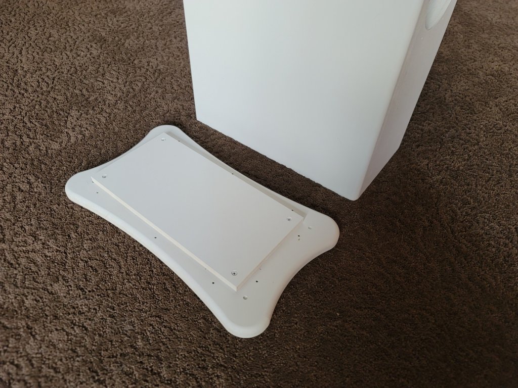

I sanded everything and put roundovers on the rest of the cabinet. Then I made some feet that will be removable and will hold the crossovers. Then I shot it with a coat of primer mainly to seal it up. My buddy is going to finish the cabinets - he plans to do a piano gloss finish on them.
Installing the No Res after the cabinet was assembled was actually not difficult at all. Most of the no res fit through the woofer openings without even needing to bend it. There was one section which required bending the No Res slightly, but it was not difficult in the least.

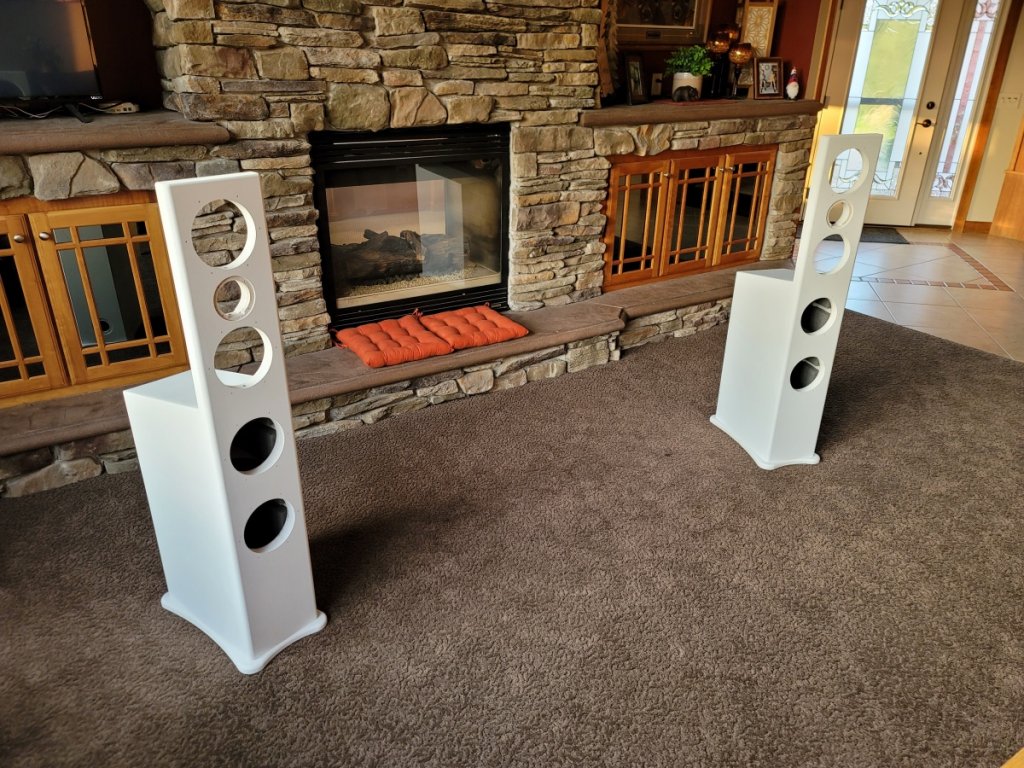

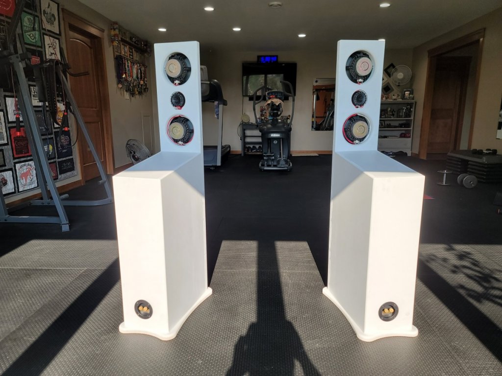

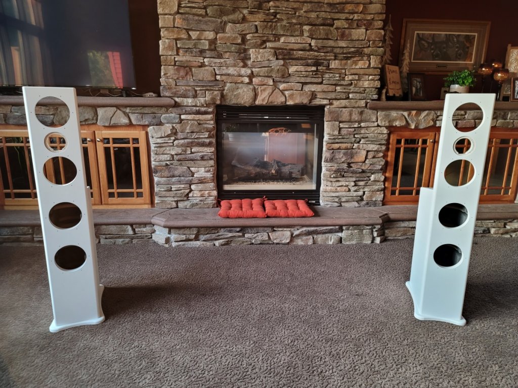

I finished the X-Statik's yesterday and got them breaking in enough to do a little listening last night. As I said before, these just have a coat of primer on them to seal them up, my friend will be finishing them so you can still see some of the seams.

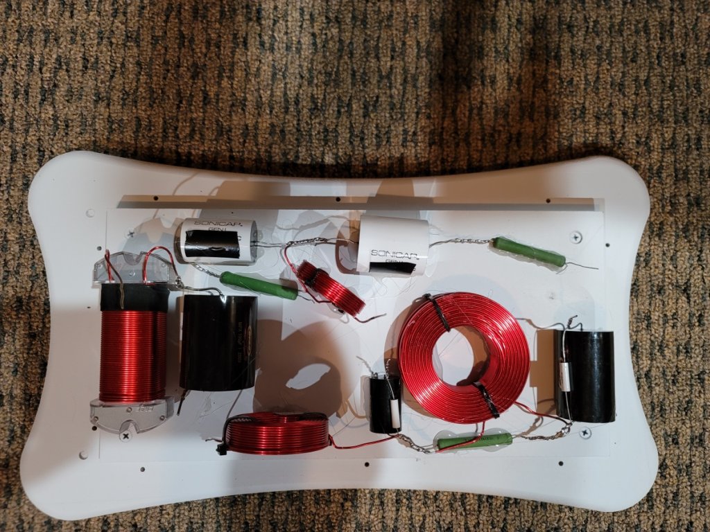

Here is a shot of the crossover all soldered up and glued in place:

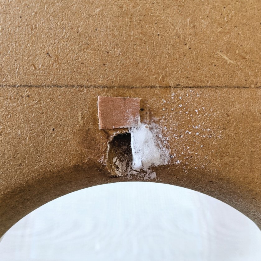

I ran the wiring so that it was long enough that the bottom can be pulled off without removing the drivers.

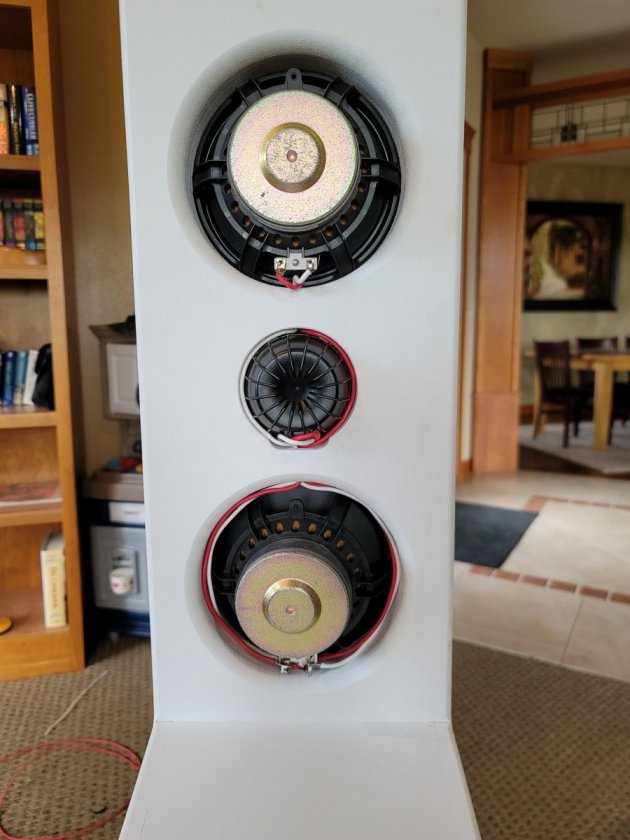

A shot of the wiring on the back. I had no trouble drilling holes in the baffle to run the wires hidden to all 3 drivers. I just used a very long 3/8" drill bit and got a good angle on it. The woofer holes are large enough that you can drill close to vertically if you have a long enough bit so that your drill doesn't get in the way.

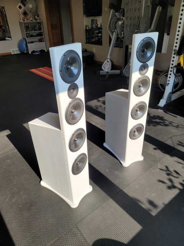

The completed speakers:
