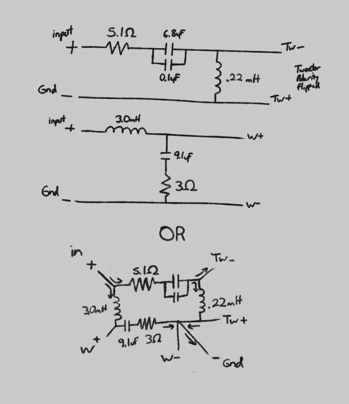

How does this schematic make any sense? There's negative lines that are marked positive on the other end and it's not jiving with what was put together in the video. The tweeter output is between the cap and inductor on the video. On the schematic it's on the end of the inductor opposite the cap. On the schematic the woofer negative has a connection to the 3ohm resistor. On the video all the returns connect between the 9.1 cap and .22 inductor
This is what I got from the video

Here's the basic schematic for the mini i just sketched up in two different ways. (Danny's already showed the full schematic on Youtube so I won't be hiding the values)
I've also included a version more similar to the way it would be laid out. hopefully one of these helps make more sense of what's going on.

Looks good to me.

But certainly the Hobbs schematic are reliable.
