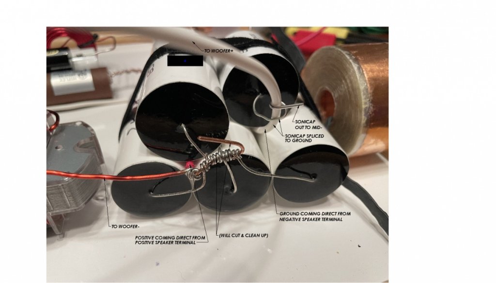

Currently I've been putting together the crossover, and if someone could verify that this is correct, that would be great.
The heat shrink is only for purposes of showing white speaker cable. The little bypass cap is inside the big bundle. The wire at the bottom right tied to the medium sized Sonicap is just solder wire as reference to where to connect back to ground:
I tried my best to design a network that used the least amount of speaker wire as possible. Using only the leads of the components when possible. I think (if it's correct LOL) it's a pretty neat network. I haven't fully finished twisting everything together, but didn't want to get too far unless I did do something wrong. Thanks! :thumb:

So on the network's mid circuit, you have the sonic cap in shunt, which provides the negative out wire.  It appears to be connected to another wire which is connected to the insulation of the positive woofer out wire. What's that for?  I'm probably just seeing this wrong.
Edit, I read your post a little more closely, now I understand. Sorry!
Hi cjsailer! Thanks for checking out the circuit for me!
Below I've provided a better picture explaining that part of the circuit. I think it's correct? Although maybe a bit different than most...
From what I see, a lot of people will connect for instance (3) leads off the positive speaker terminal, one to high, one to mid, one to low. I'm trying to get rid of this as much as possible and splice as far up the line to eliminate as much redundant circuitry as I can. The only negative I could see (which IMO should be a positive?) is that at points you're running nearly the whole signal through one piece of the 14ga speaker wiring on the xover... Hopefully that's not an issue?
So, for simplicities sake (this does not match my xover, this is just a general question), I've made a quick sketch explaining what I'm trying to do:
Is there an issue with splicing down the line like box #2?
I just watched Danny's Youtube video he made 20 or so hours ago about wiring up the "minis", and he did a run similar to option #2, so I don't think this will be a problem...
