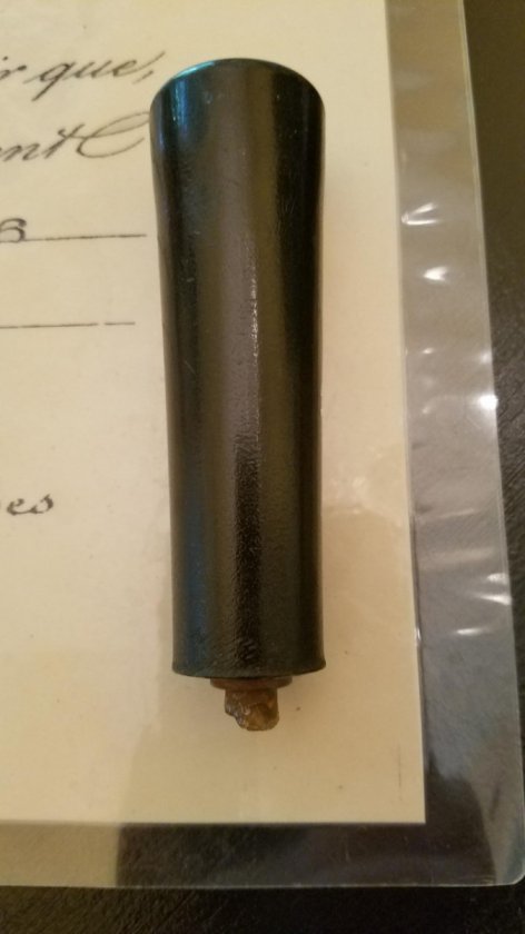

This actually is inside a plastic handle that attaches to the crank on my trailer lift.

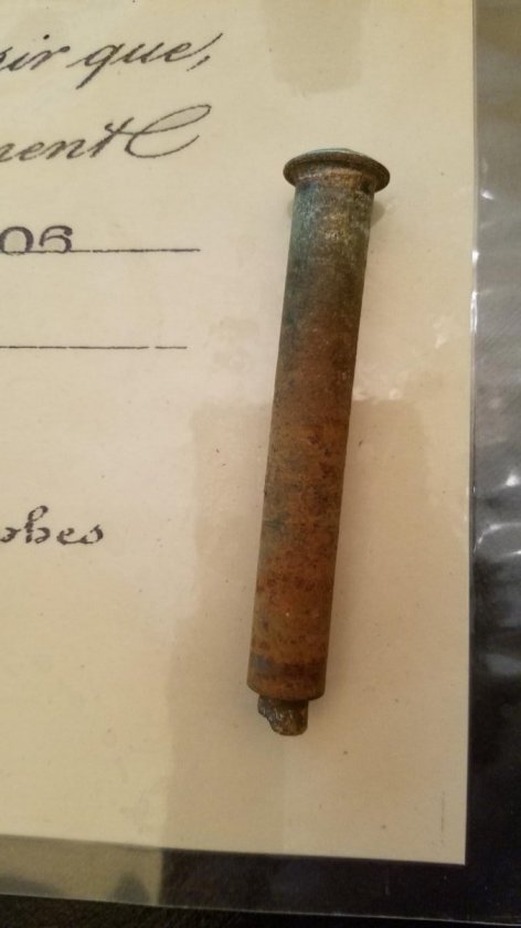

The bolt sits loosley (so the handle will spin when cranking it) inside this plastic handle and sticks out the bottom, were it not broken would be a nut at the bottom to attach to the hand crank:
The bolt as shown is 3" long (so unbroken would be longer), thickest part is 1/2" wide, bottom part which fits into hole to attach to crank is 3/8 " wide.
Not found at trailer store, hardware store, or Lowes/Home Depot. Not sure where to get this heavy duty type of bolt. Do you know?

I had the same issue a while back and had to make up one.  I added some tubing over a bolt long enough with the correct thread and a washer or two.  Its was that or a new jack.
Here is 1 that is close at $112.00. Well it is Stainless.
https://www.fastenal.com/product/fasteners/sockets/socket-shoulder-bolts/602314?categoryId=602314&level=3&query=Shoulder&isExpanded=true&Finish=Plain&productFamilyId=30220

McMaster Carr  https://www.mcmaster.com/shoulder-bolts/

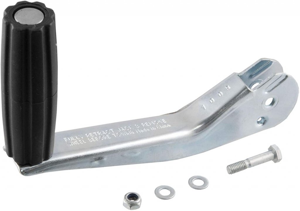

Unfortunately the trailer is at the barn so unable at this time to post the jack crank arm this attaches to. It is a typical kind of crank, nothing special. Looks something like this:

I'd put a bolt in of proper thread, a couple of nuts to secure it, and cover it with a piece of PVC and large fender washers myself.

Here's what Grainger has in 3-1/4" and 3-1/2" length x 1/2" diameter x 3/8"-16 threads

Hmm ... interesting. Only 2.5", but might work. Thanks @Bob2!

If the arm is wide enough I'd be tempted to drill the hole out and tap it to take a 1/2", preferably stainless steel, bolt. Use a nut on the topside screwed up tight to the end of the thread and a nyloc on the bottom, preferably with Loktite. Would cost maybe $10 a lot less than the $112 mentioned above [even for stainless that is way to high]. Handle? A nice length of garden hose  :D.
The existing 3/8" just looks a bit too thin, even if rust was a factor.
