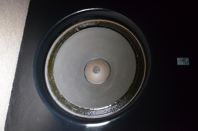

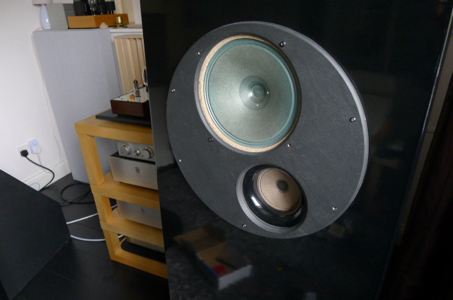

I dont know this wood, but In OB vibrations are small there is no box, I could use the cheapest or real wood if funds allow.
If I put my ear to the main baffle I can quite easily hear the mid range driver playing its music. My main baffle is 55mm void free birch.
I guess this means the main baffle is vibrating along and will eventually re-emit those vibrations to fog the SQ. It may be less than a box but in the quest for ultimate SQ would contribute. I live by the saying that in sound quality, everything matters.
Equally the 15" bass driver will be transferring its vibrations to the mid range driver.
OB builders have chosen various alternatives to alleviate this effect which include the use of separate 'isolated' baffles for each driver and mounting drivers from their magnets. I was hoping to explore the option of a vibration 'free/adsorbing' baffle.

Vibration is definitely a factor in OB, as there is little to no bracing to dampen or break it up.
My approach has been to separate the bass units from the midrange and tweeter. Easily done when using GR research OB bass.
For the midrange/tweeter baffle, a sandwich construction can be a good idea.
My baffle is made of steel, to which a 30 mm baltic birch board has been glued, with a 2 mm layer of non-hardening marine glue.
The midrange drivers are mounted in the birch board, not the steel front baffle.
/The Priest
Interesting and a good option if you are starting from scratch. For me its about a 12-20mm panel mounted in front of the main baffle as in the picture. I quite like the idea of a sandwich construction, but open to any other ideas.

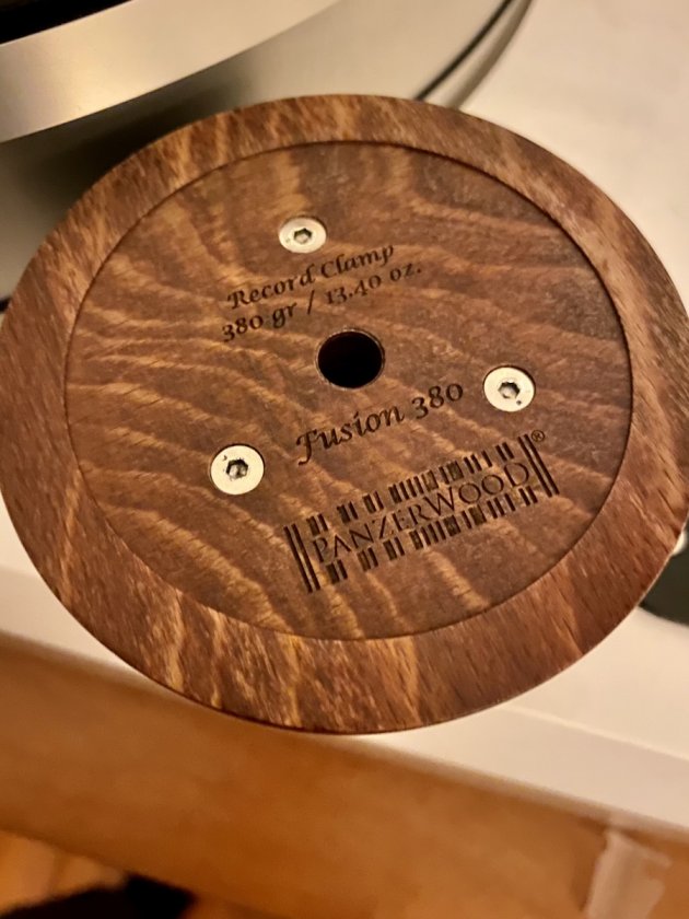

Anyone use, or considered using Panzerholz 'wood' for OB baffles? It seems to have amazing qualities that reduce the transmission of unwanted vibrations.
So I use a Panzerholz record weight on my Acoustic Signature Triple X with amazing results. I would imagine very pricey but would be fantastic for baffles. I think my Spatial M3’ Sapphire baffles are quite nice though  :icon_lol:

My mind is now turning to using the existing 12mm birch ply circular baffle, but mounting it on say a 5-10mm sound absorbent sheet.
This will combine the merits of a sandwich construction and a sound absorbent material such as closed cell 'rubber'.
Its a technique which used a lot on automobiles to remove unwanted noise.
Any suggestions for the composition of the full gasket.
