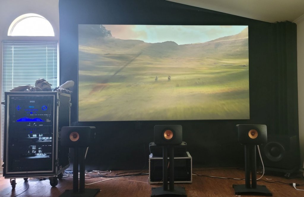

Hi, I'm new to Bryston but am interested in a good 3 channel amp for my front 3 and it looks like a contender!  I have Kef LS50's (two Meta, one original version) across the front and typically cross them at 70 Hz to a Rythmik F12G sealed servo sub but rarely do run them full range when connected to my Chord dac and not my XMC-1 Pre/Pro. They are rated at 8 ohm but in reality are 4 ohm speakers.
What are the differences between the 6B SST² and 21B³ 3 channel amps?  They seem really similar and are similarly priced too.
Do you think they are overkill?  I listen at very low/moderate levels 95% of the time but do crank them up occasionally for both music and movies and want them to rock when I do.  I will likely be rack mounting, but not a deal breaker.  I currently have a Parasound A23 for L/R and Emotiva A-500 for Center.
I am also considering the Parasound A31 (or two A21's) which are much cheaper, but I assume the Bryston is a huge step up from it?
Any advice is welcome, thank you :)
(just blacked out the wall this week and loving it!)
