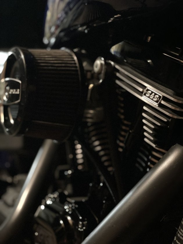

2006 Dyna Street Bob FXDBi... my other money pit :lol:

2006 Harley Dyna Street Bob FXDBi 6 Speed
140hp & 142tq
S&S 124"
All Forged Internals
10.8-1 Comp
S&S gear drive 640 cams
TC3 cam plate and oil pump
S&S Oil Pan & Oil Supply Lines
D&D Boarzilla exhaust w/ perforated baffle
SE 58MM TB & Runner
R&R Intake
HPi 5.3 Injectors
Jagg side mount Oil Cooler
Vulcan solid compensator eliminator - 34 tooth
CVO primary chain tensioner
2007+ welded Stator Rotor, primary cover ground for clearance
AIM Stage 3 VP-Performance clutch VP95 IV w/ 380lbs spring
Vulcan Chain Conversion Kit (24T Front Sprocket & 51T Rear Sprocket, 5th gear ends @ 130 - which is quarter mile speed)
BikeMaster 530 11,200lbs chain
Dynojet Power Vision - EFI Tuned by Jamie Long @ Fuel Moto
Progressive front fork internals
Progressive rear shocks
Night Dragon 110 front tires, 180 rear
All fuel lines, pump, pressure regulator replaced for increased flow
All electrical gone through
Too much powder coat to list
I'm proud to say I did all the work on the bike myself, minus the EFI tuning.
Bike runs better than any Harley off the showroom floor... The only thing that is still Harley for the power/drivetrain is the internals of the transmission. These usually can take up to 160hp without problems... One thing Harley got right :lol:
Want to upgrade to Radial front and rear calipers (Brembo or Tokico) with Brembo Master Cylinders, and Lyndall Rotors/Pads. May go dual front brakes, but not sure if it's worth the extra mass. Possibly going to go with Suzuki GSXR inverted front forks, which you re-spring and re-seal with heavy oil for the extra weight, and extensions on for the extra length. Also Ohlins rear external reservoir shocks.
A serious riot to ride.... Bike will spin all first 3 gears with no problem, sometimes will spin into 4th - depending on the pavement and road/tire heat.

Interesting 2x1 exaust, how do you manage the rear cylinder heat ?
I haven't had any issues with overheating, and keep a close eye on the temps. I have an oil cooler that generally will lower temps 20-30 degrees (if you're moving), and run on the side of rich, which helps as well. Fully heated up the engine temp (not oil temp, or calculated head temp) is usually around 220-270. It seems to hang out around 250 most of the time.
This is a lot of heat, when I had a bike a buddy had a Virago 1100, in the winter the heat was OK but in the summer the engine heat was intolerable. Too bad Harley copied the engine and look of Indian and not the engine of Moto Guzzi or BMW which has no heating probs what persists to this day.
