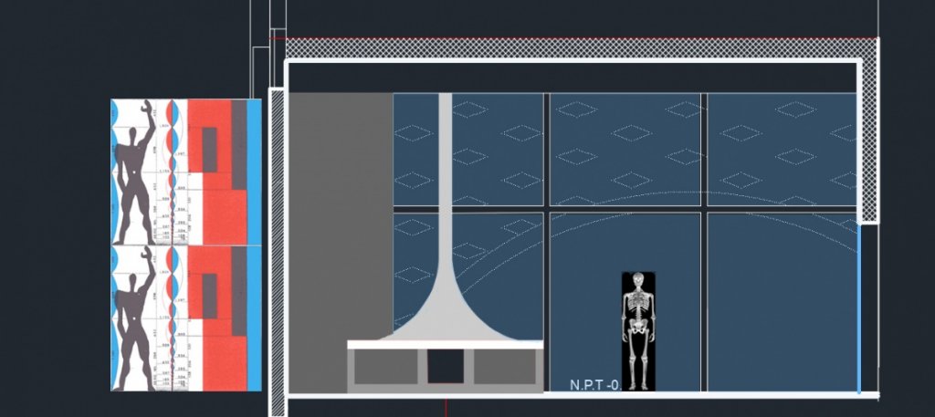

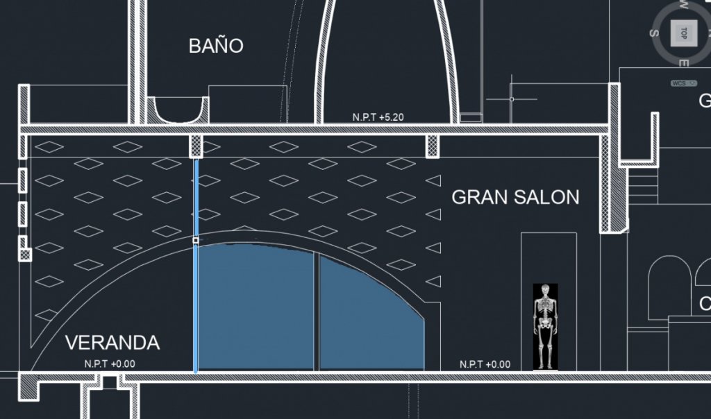

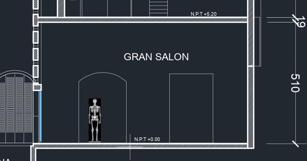

As the room is not yet build, any wall and ceiling design ideas can be altered, structured, paneled etc. I wish for a room with space integral solutions, avoiding added stuff later cluttering the space.  (The purple rings are ceiling fans, the red blocks represent the speakers and 2 subwoofers)
As seen in the attached drawings the room got a full size 6x12 snooker table and sitting arrangement with the music system, speakers are 7 feet away from the wall, 2.5 meters (8.5 ft) apart, and listening distance is 4.6 meters (15ft). It's a starting point and all can be changed. For inspiration I am looking at the shoebox like but world famous music Music room in la Chaux-de-Fonds in Switzerland. (see picture attached). Any literature and design clues for how to make the most of the design is very much appreciated. And yes, the fireplace design is a direct quote of the casa Curzio Malaparte in Capri by Adalberto Libera.

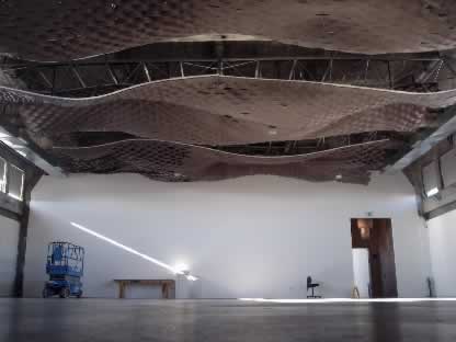

an other interesting bad cube shape space that I saw completely transformed from impossibly bad acoustics to an ok acoustics with the ceiling treatment of suspended felt. It worked really well.

As to the question of integrated acoustic treatment products, there are some newer products since the Salle de musique was built, which might be of interest. You could consider Modex Plate (https://www.rpgacoustic.com/modex-plate/) or similar VPR absorbers, also Soundply (https://soundply.com/) or similar microperforated absorbers for wood-paneled walls, Clearsorber (https://www.rpgacoustic.com/clearsorber-panel/) for the large glass surfaces.
