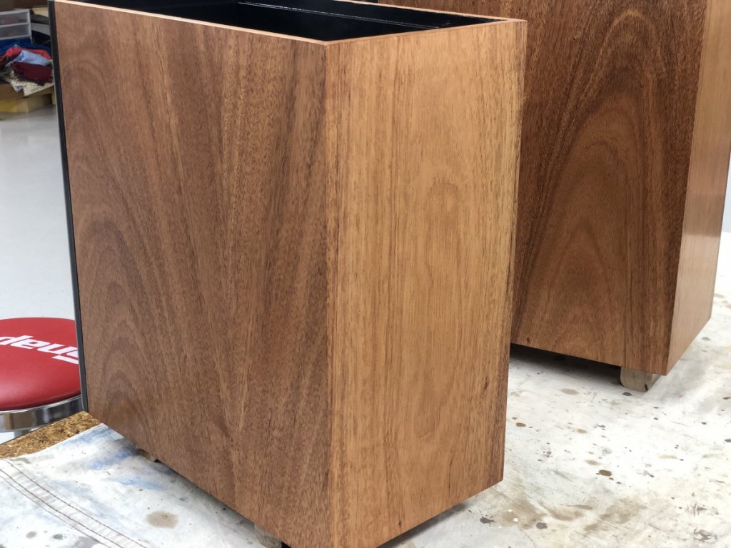

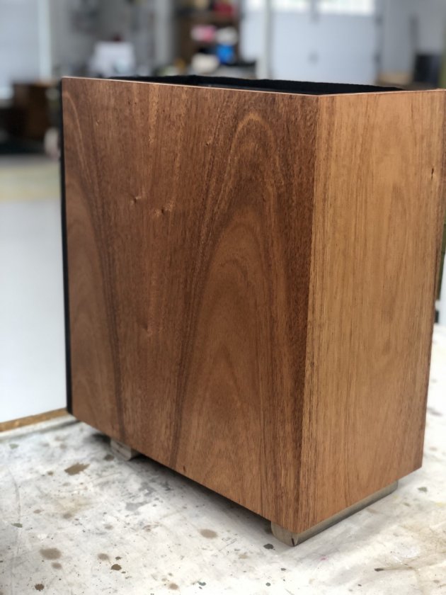

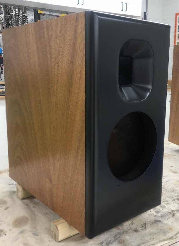

Just completed the box build of my NX Studios. Odie's Oil on an African Mahogany veneer. Two part automotive paint on the front. Overall, very happy with the flat pack from Jay and the veneering portion of the project. Now, I await the internals of the speaker.

Initially, three coats of 2K rapid filler gray primer with sanding between coats before spraying three coats of Spray MAX 2K hot rod satin black. I absolutely love the low luster. I may have gotten carried away with the cosmetic portion of the build as I await the kit portion from GR.
Odie's Dark Oil was applied three times before moving on to the wood butter. Three applications later, I moved on to Odie's Wax. Two applications of wax seemed sufficient.
